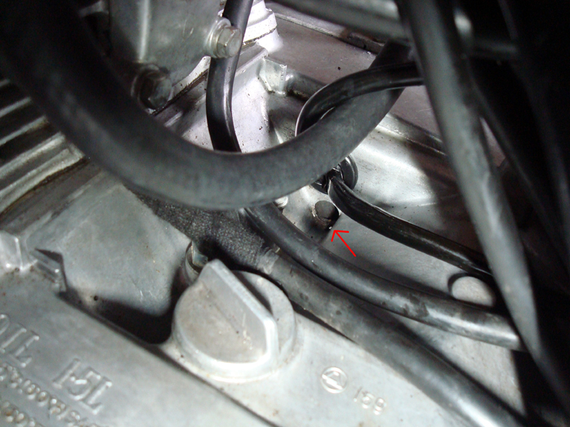

But the biggest and most important tip I can offer when working on the carb’ is to put a piece of rag in the drain hole under the carb on the drive side. It is easily big enough to swallow a M6 nut or washer which is not so convenient.
