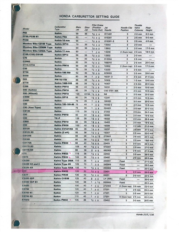

Honda carburetor settings guide
Post by garncarz » Sun Sep 06, 2020 6:13 am

Thanks for posting this, the first time I've seen the jetting details for the PW22 so called CYB (-810) 'race kit' carbs.
I knew they were basically the same carb as used on the road bike just jetted differently, now I know the differences. Thanks again.
