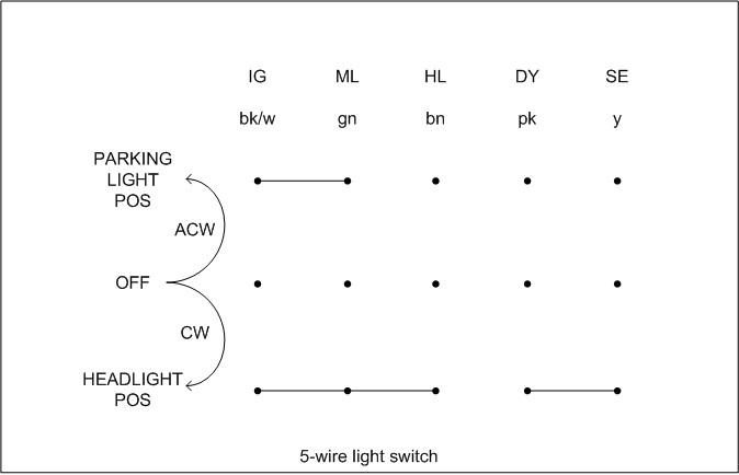

I have a switch I just took off a CB77 headlight bucket that only has four wires coming off it. No brown, but the green has a double hookup. Is tyhis possibly for an early CB/CL77? Maybe the brown wire on the harness plugs into the green plug? Thanks for any and all info. Only guide I have shows five wires. Charlie

yup...looks to me like the green wire from 4-wire switch connects to the brown wire from dimmer switch among other things...then there are some green with white trace wires in there to confuse things if I remember correctly...

Some markets disallowed the use of the parking light during riding, therefore the headlight dimmer (dipswitch in UK English) & parking light (HL) and the meter lamp (ML) were connected together. I guess these markets also didn't allow the dimmer switch's midpoint detent, whereby neither the hi nor lo beam is on, either(?).
