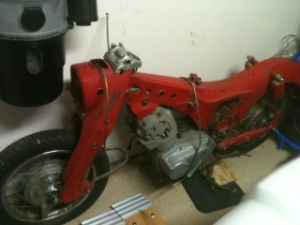

Thanks for the info G-Man! I hope to pick this little jewel up this week and will inform you of what I find. It doesn't have the pipes on so......after looking on E-Bay I see that they don't come cheep! I'm giving a $150.00 for it....with some bits missing....handle bars...headlight bucket.....seat......pipes......most I have located already. I'm sure I will have a ton of questions......glad to see this forum, they are a great help in bringing old bikes back to life. Thanks again man!
- here is a pic of it on craigslist
- project.jpg (7.99 KiB) Viewed 2706 times

It's a done deal...will pick it up this Sat.!!!!!!!! More pics to come! It's here...on the lift for a look over. eng. # is: ca77e-1026348. Frame # is: ca78-1026315.
