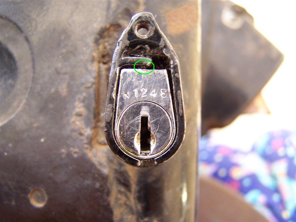

G'day G-man
In the attached photo, is the highlighted item where the little brass stud is?
Thanks for your help.
'64 C72
'62 C72
Post by G-Man » Mon Jun 13, 2011 4:40 am
Muddy
My error - I was thinking about CB72. From your picture, it looks like you have to press that little steel strip upwards and it should release the lock barrel.
