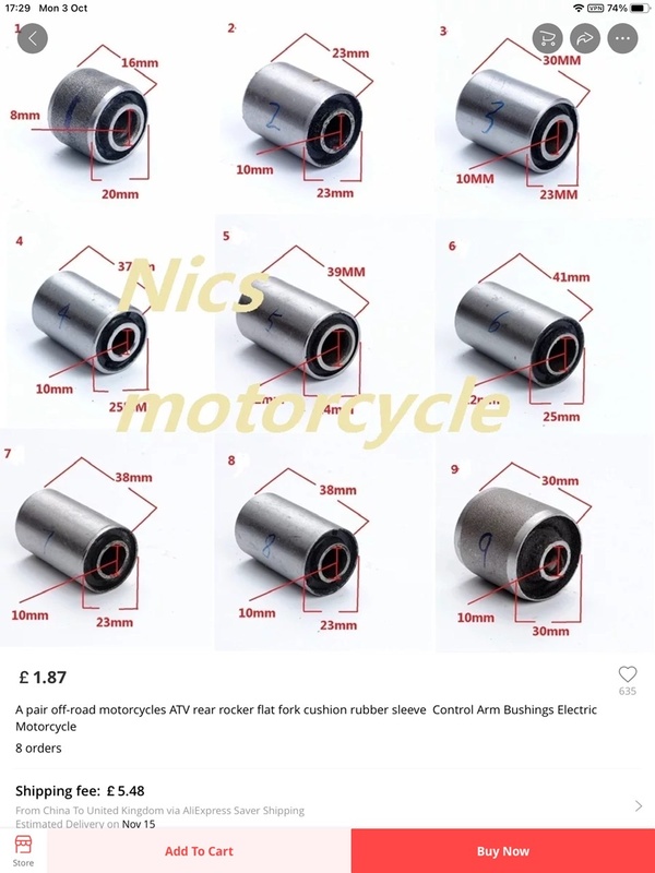

Have you tried Ali Express, I needed replacement bushes for the brake anchor arm on my CA77 and found a place that has many sizes of sleeved rubber bushes. I had to shorten them slightly but got the diameters internal and external I needed.

Post by Geoff Hastings » Mon Oct 03, 2022 11:32 am
Sample of bushes available

This is about shock absorber (dampeners) rubber mounting bushings. I have replaced several “brake link” bushings available on fleabay and through CMSNL andHonda dealers. Will investigate using Urethane in the links later. Would have to burnout the old rubber and knurl or sandblast the metal parts to get good adhesion. 3D printing a jig to hold parts centered would be no problem.
