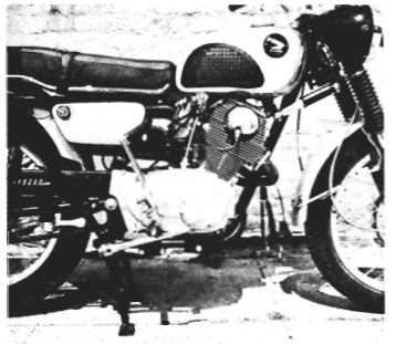

Attached image is taken from a period road test from 1965 of what would certainly have been a 'new' IE not messed with bike. Hard to see clearly but if you look close the kick start arm is at the 11 o' clock position as specified by LM.
That's about where mine is and it works fine, one 'notch' lower and you don't seem to get the full swing on the kicksart lever, one higher, and for me at least it's hard to get my foot high enough to reach it!
11 o'clock high should be fine.
