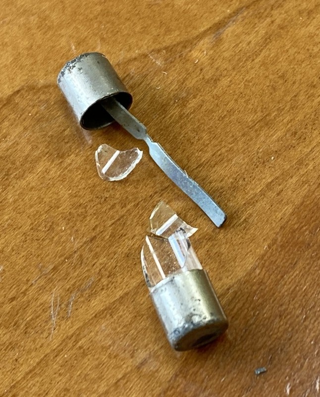

Ha! - well that was the problem! Not only was the cap loose but the fuse had fallen apart, see image.
Thanks, I would have got there eventually but this saved me some time - vibration over 50 years you think? I doubt very much if this is the original fuse but I have owned the bike since 2014 and have never changed it...
