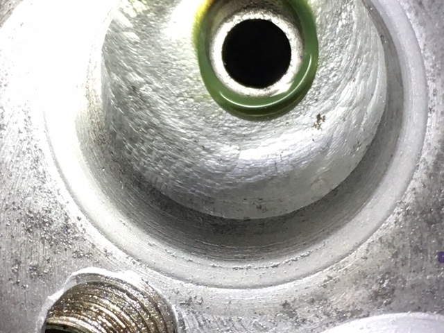

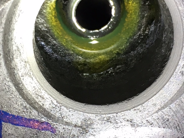

I am looking for opinions on how to deal with the pitting on my left cylinder valve seats. The valves themselves are completely clear of any pitting as are the right valve seats. Will this amount of pitting be a compression problem? Thanks for the input!!

Were this mine I would take it to a machine shop that can cut the seats and valves for you. The upside is that new machinery makes it likely that your valves will seal better than they did at the factory.

Or, you can do what I did: lap the valves in, assemble head, pour gasoline into the ports and see if it leaks into the combustion chamber. No leak = good to go!

+1 what Nick said. that has worked well for me as well. A slight weep may be acceptable but a seep or leak is not.
Somewhere in these pages I seem to remember that you can not grind these valves much because of the way the valve is built. Any further info from others would be appreciated. Sorry but it has been a while since I've dealt with these matters. Rusty

I think that amount of pit in the actual seat face requires cutting new seat and cutting at the top area to acheive the proper width seat.
Usually the intake valve can have the face ground also the stem.
Not so with the exhaust.
The face is hardened and can't be ground.
I do complete heads (all parts) for $125.00 plus any required parts. ...................lm
