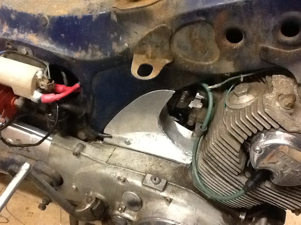

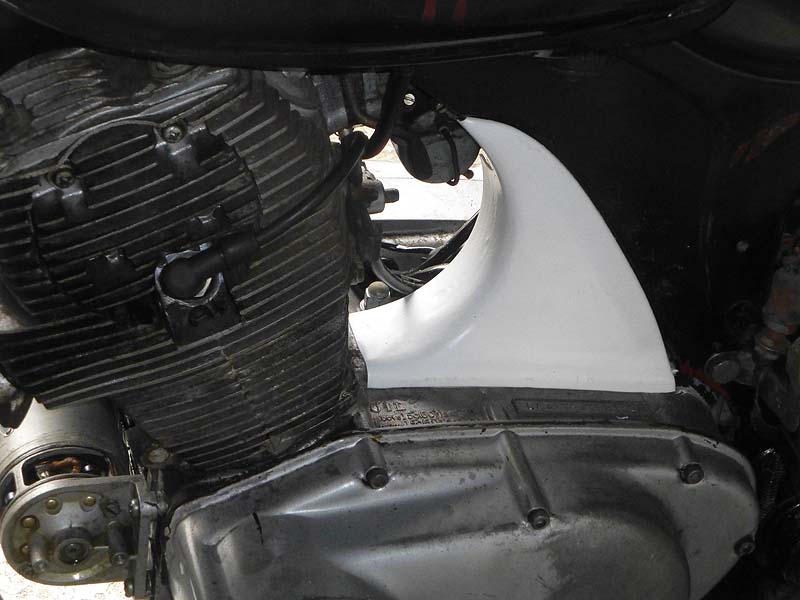

I like the alloy cover & I too was thinking about alloy, but I have no alloy-welding gear.
I have already fabricated a pair of vac-formed units, rough at the moment, made as a concept to see if its viable, & I will either make from ABS or GRP, not sure yet!!
Pic of 'MK1' shape is wrong, but MK11 should be a bit more like it!!
casamere, I jumped in & 'ordered' the covers only to find 'no longer available' !!
Thanks anyway.

Once again, great job, vacuum forming is an area I've not investigated but you produce some really good replicas. When I made mine from aluminium I used Lumiweld which does not need proper welding equipment, a propane blow torch is sufficient, just like soldering really. Your advantage is once you have the mold you can produce as many as you want. I can see a market there, they seem to be one of the most commonly missing items.

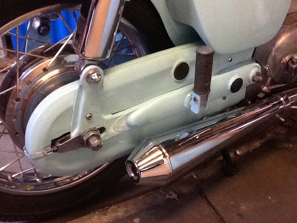

New stainless rims & spokes & tyres, everything blasted & painted, rewired to take modern regulator/rectifier, lotsa chroming done, & now have a 'rolling-chassis'!
Not a fan of 'high-bars, so I fitted a low set.
Cases back from blasters, engine nearly rebuilt.
I painted it according to G-mans research, thank you sir.

Lovely job! Who did your aquablasting? Would you recommend them?
I think you said that you were close to Prestige. My stuff should be ready next month. Maybe we could meet fro a coffee?
