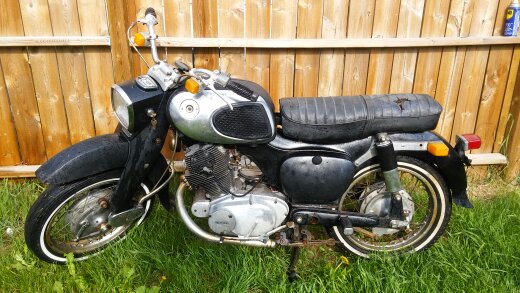

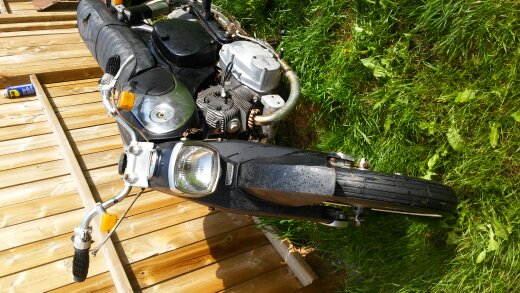

I have been a huge Honda fan for a long time. When a complete stranger asked if i was interested in his 62 honda dream 305 I said yes. We settled on $500 i don't know if this is a good deal or not but I love the styling and the history so I bought it. I'm going to clean it up a little and get it back on the road. Today was day 1 of the project. I began to disassemble the bike and sandblast the parts in my garage so that I can repaint it.[/img] I will post more photos every day that i work on it. Hopefully when it is finished i will have a reliable easy riding bike that I can enjoy on the bendy roads in Alberta and British Columbia.
It does not run yet but I hope I will be able to fix it.
This is what it looked like the day i brought it home.

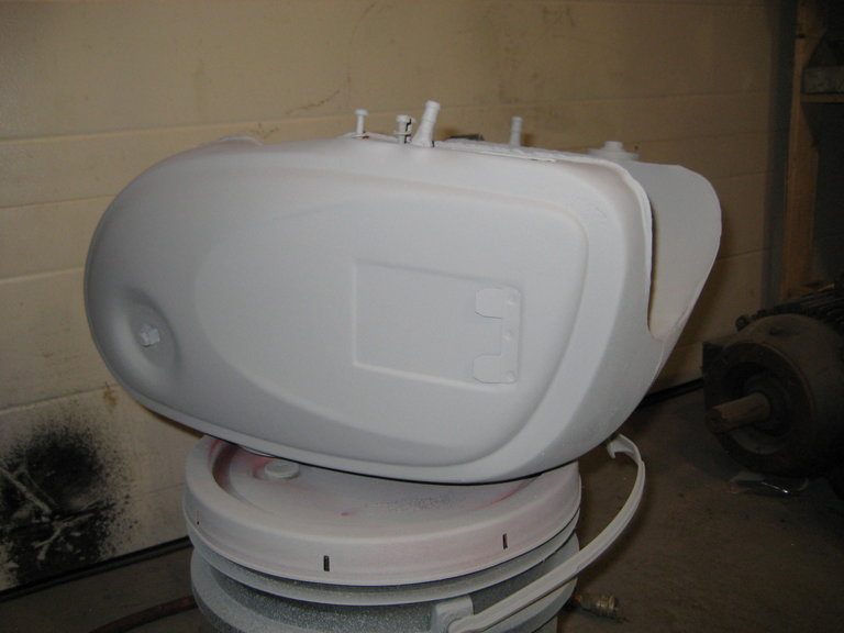

This is what i got done today.I'm just working towards cleaning it up so that it is presentable.

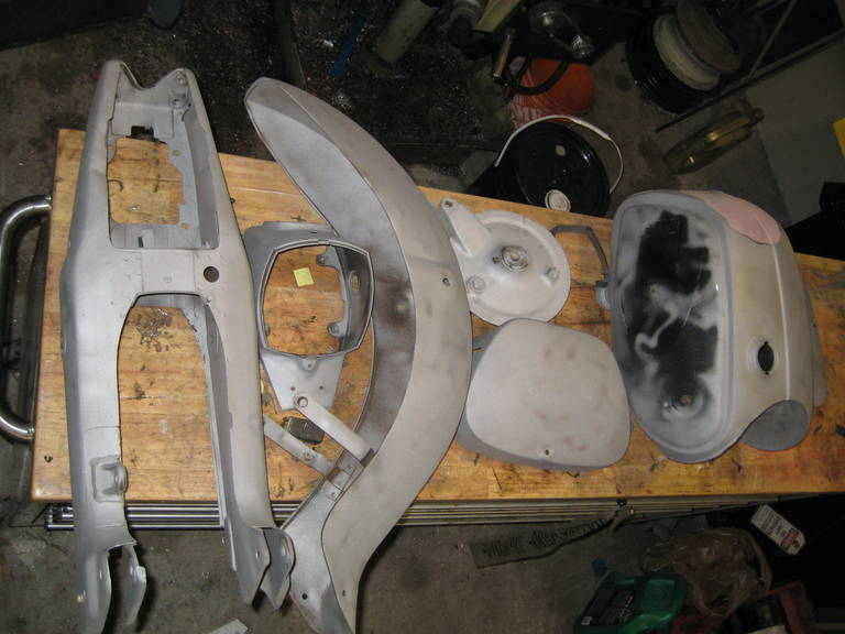

parts off the bike i blasted in the garage
rsz_1img_6132 (1).jpg (41.62 KiB) Viewed 2503 times

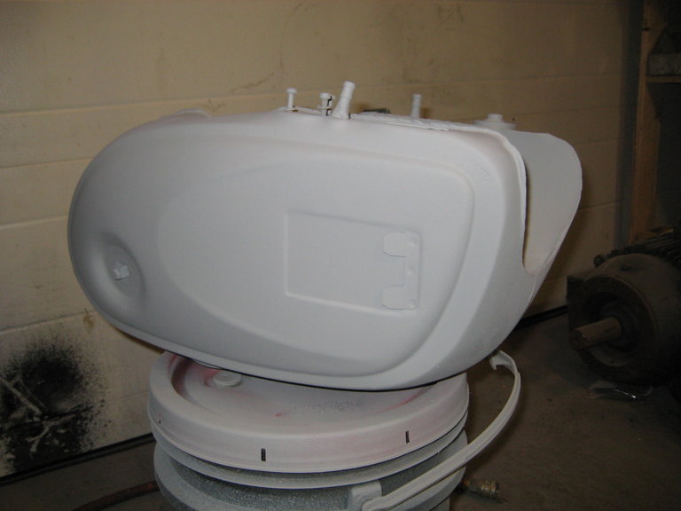

I put a coat of primer on all the small parts using an HVLP gun

Re: 62 C77 Barn Find
Post by Hoosier Tom » Thu Jun 01, 2017 1:08 pm
Clarke wrote:I have been a huge Honda fan for a long time. When a complete stranger asked if i was interested in his 62 honda dream 305 I said yes. We settled on $500 i don't know i
Welcome. Visually, that bike is not a 1962. Earliest for that style (Late Dream Touring) would be 1963. If you supply the forum with your frame and engine numbers we can give you a better idea of the year.
HT

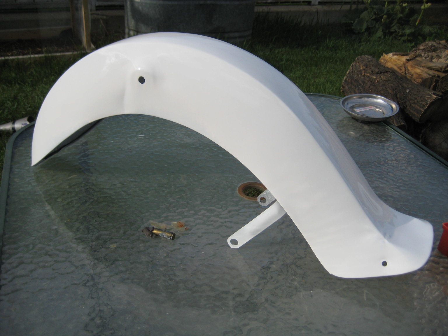

I spent this morning hand sanding the primer to get everything smooth. Then i moved on to painting the paint i am using is Acrylic Enamel. Unfortunately I am going to need to sand down a few parts and re-paint them I had a few bad runs because I put the first coat of paint on to thick. As I am writing this I suddenly remember that I was still using the larger 1.8 tip that I had just used for the primer. oh well I can try again tomorrow. here is a picture of the front fender so you can see the color I chose. Where can i find the frame number? I see the motor number but can't see a frame number on it
front fender an off white with a bit of red mixed in
Re: Painting
Post by LOUD MOUSE » Fri Jun 02, 2017 7:03 am
Near rhe left side foot peg and center stand mount. ...............lm
Clarke wrote:I spent this morning hand sanding the primer to get everything smooth. Then i moved on to painting the paint i am using is Acrylic Enamel. Unfortunately I am going to need to sand down a few parts and re-paint them I had a few bad runs because I put the first coat of paint on to thick. As I am writing this I suddenly remember that I was still using the larger 1.8 tip that I had just used for the primer. oh well I can try again tomorrow. here is a picture of the front fender so you can see the color I chose. Where can i find the frame number? I see the motor number but can't see a frame number on it

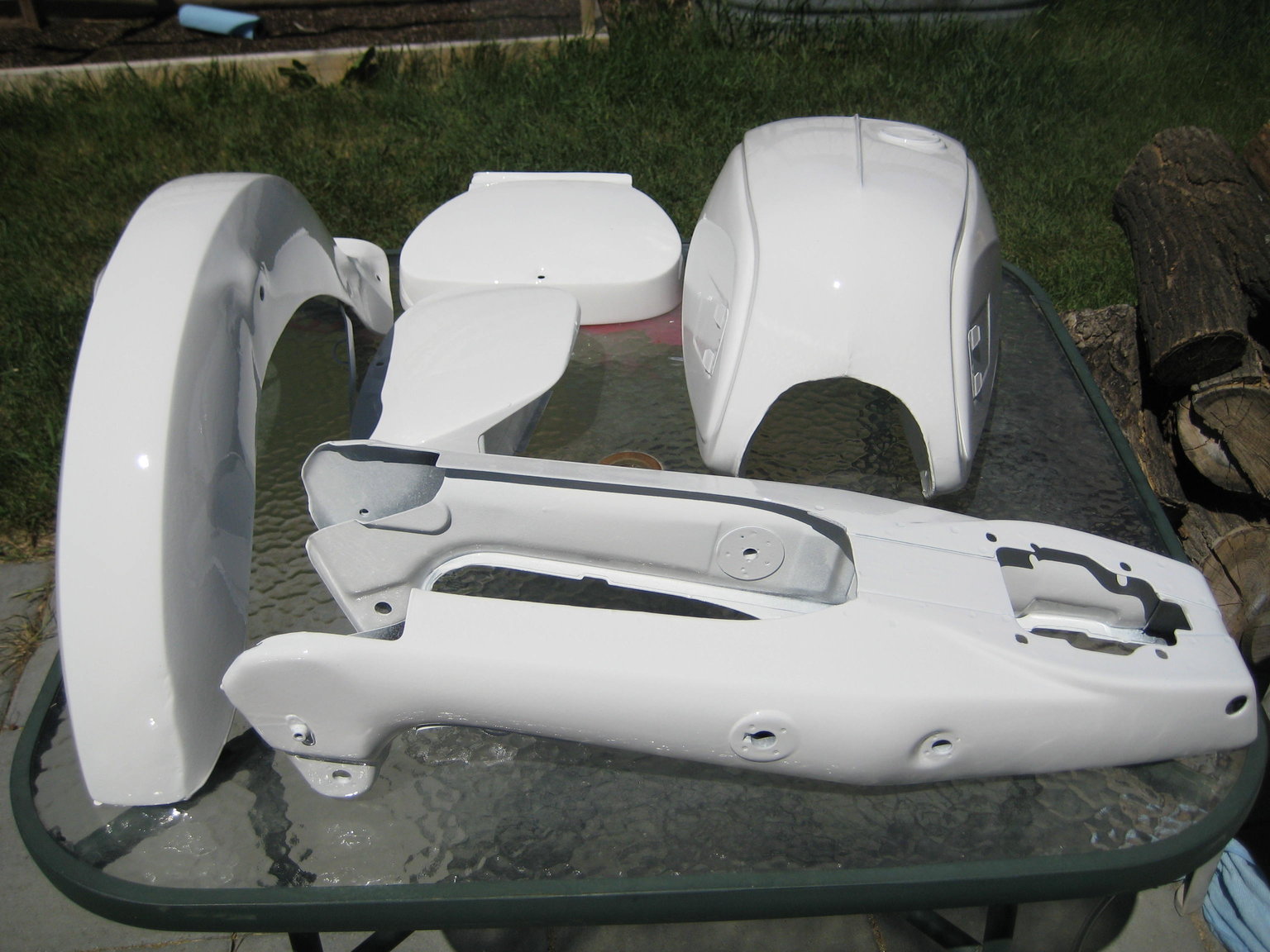

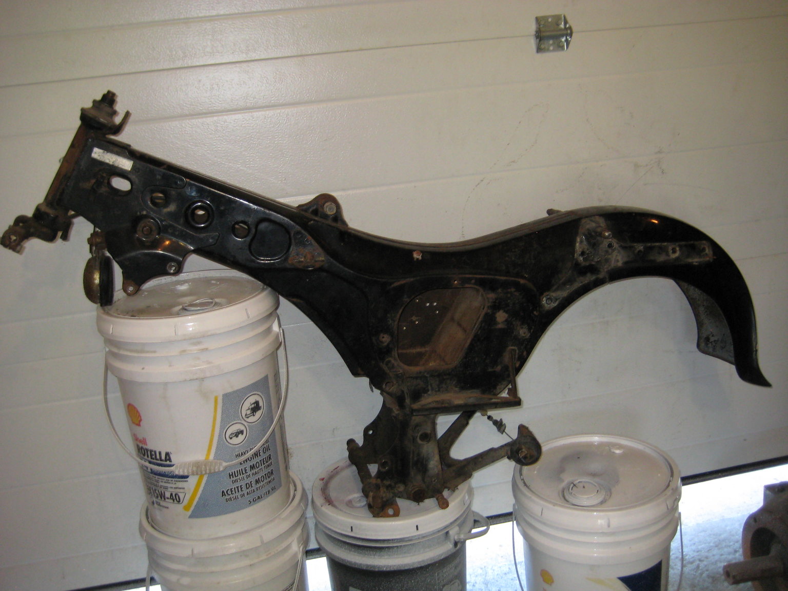

Today I spent a few hours Hand sanding parts to get them smooth and installed a 1.5 tip in the paint gun. The paint work today went much better. Im happy with the results and I am moving on to sandblasting the frame. Found the frame number thanks Loud Mouse for helping me find it. posted a few pictures of what I'm working on.
finished parts ready to go back on the frame
bare frame ready to sand blast. it doesn't fit in my blast cabinet though.

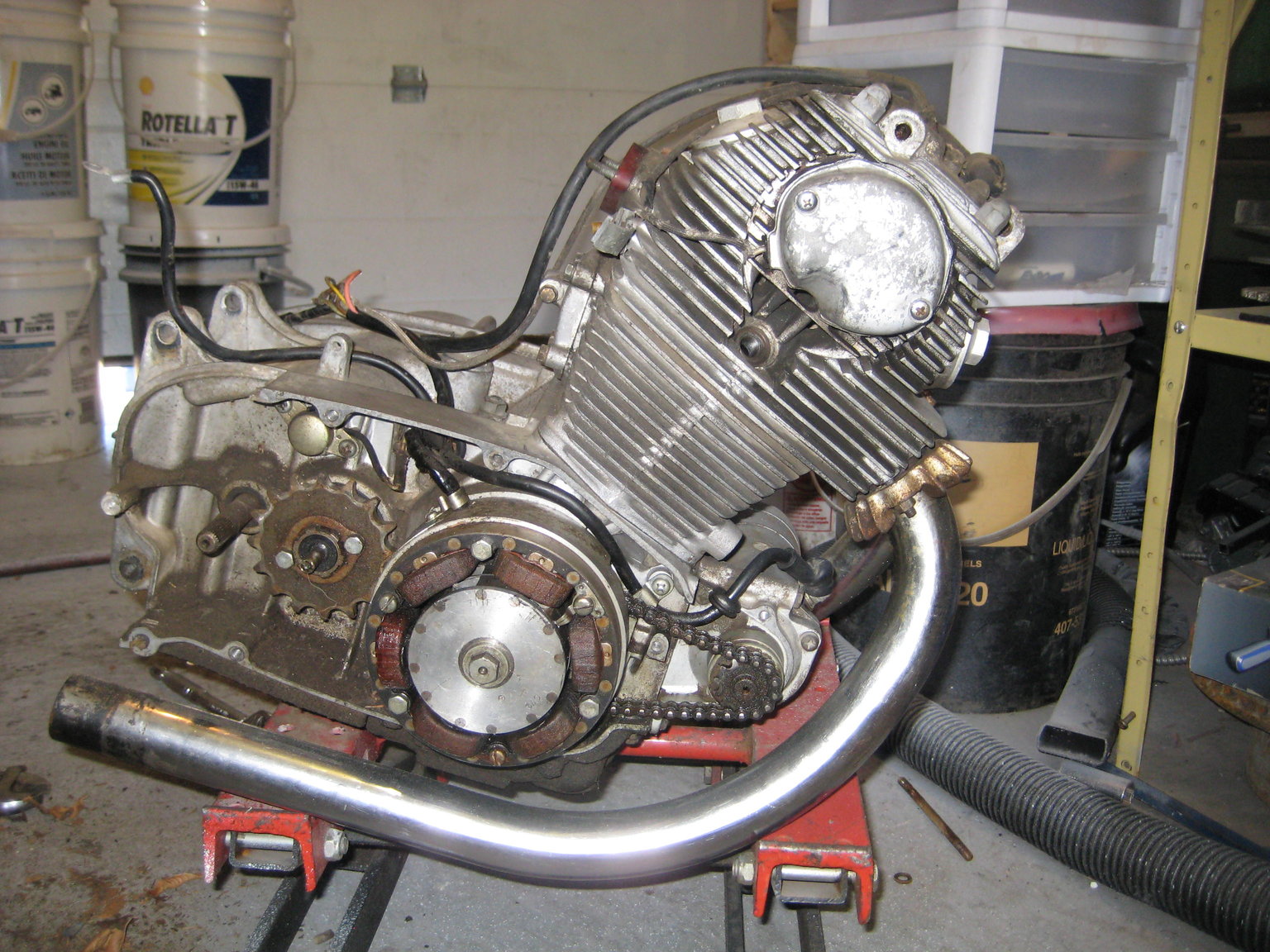

not really sure how i want to clean up the motor. any suggestions?
