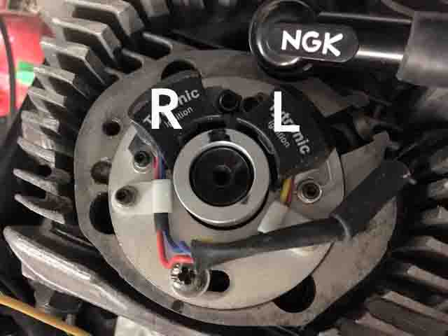

Post by Geeky160 » Fri May 05, 2017 8:12 pm
I know the answer.....now. What cylinder would you assign to what sensor?

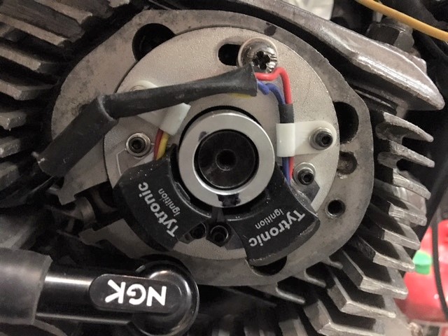

Post by Geeky160 » Sat May 06, 2017 8:44 am
My error was looking at the EI sensors in the original position, with the sensors up. I ended up having to mount the plate facing down in order to clear the points cover. I assumed the left was left and right was right but that is not correct. I should have used the heels that contact the points cam as a reference.
Tytronic 2 Flip.jpg (23.68 KiB) Viewed 5142 times

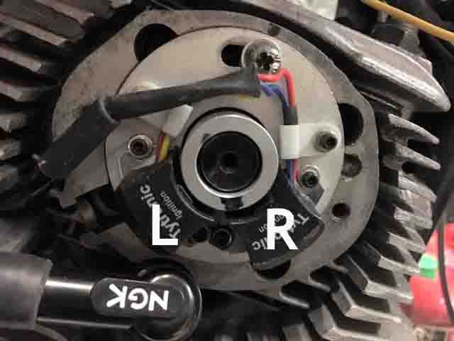

Post by Geeky160 » Sat May 06, 2017 9:53 am
So in the end, this is what works. I guess being semi dyslexic didn't help.
Tytronic 2 Marked.jpg (23.78 KiB) Viewed 5132 times

Post by Geeky160 » Sat May 06, 2017 1:27 pm
If anyone sees this later and is installing Trytronics, You HAVE to center the sensors over the spark plug because of the recess in the points cover. You will have to set the timing within the small range in that spot and the little amount of adjustment the sensors themselves give you. I finally got it together and running correctly. I also had to trim the points cover gasket to give the new wiring enough room.
