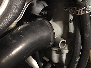

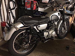

Hey All,
I recently acquired the bike I've been drooling over, a 1967 CL77. The previous owner and his son had done a nice job going through most everything with an eye towards function if not always perfect restoration. Not a problem for me as I plan on riding and enjoying this thing.
So I took it out the other day. It had been having trouble starting, but a few days on the trickle charger and some new plugs and it fired right up and was running great. I shifted through the gears until I was up to about 50-55 mph (pretty exciting on this bike, but that's what traffic on the country road was doing). All was well until the first hill when I felt the first sputter.
Now, I'm used to sputters. I've felt them on my other old Hondas, usually when I forget to turn on the fuel petcock. But this time the fuel was on and the bike kept running, just with an intermittent decrease in power, even with the throttle wide open.
I've actually felt something like this one other time on my '73 CB750 and eventually traced it to cracking boots between the carb and air filter. Fresh, soft rubber and new clamps, and I never felt it again. Looking at my CL, I noticed that the boots don't have any type of clamp at all. I looked online and found these spring types but wondered a) is this what people are using vs. ring clamps with tightening screws and b) does this sound to anyone else like an air leak here could be the problem c) what else should I be thinking about?
Thanks in advance for any input!

These bikes had a tendency to have the cap go bad and not allow air in.
We would open the cap to prove this was the problem then leave the cap half open until we could replace it.
HONDA did offer this- Drill a small hole across the one already there under/near the seal gasket.
I did that once but found I cured the vacuum problem with gas on the tank. .............lm

The spring thing works fine.
Also check the vent tube on the bottom of the bowl for blockage. .............lm
