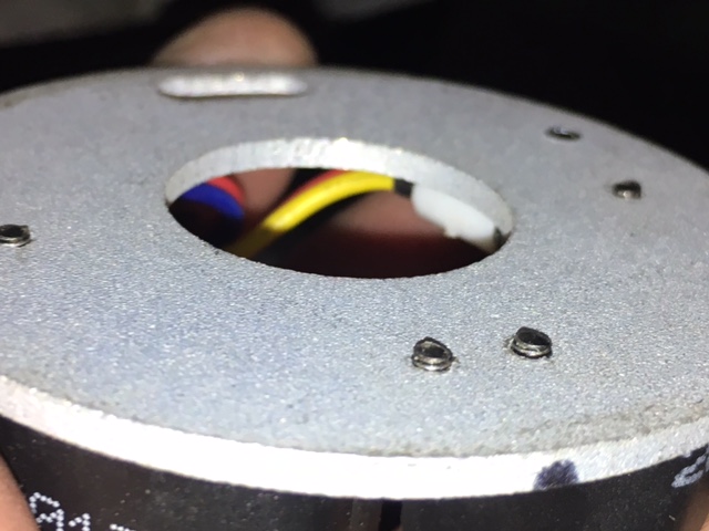

Before you go further, I would install the new assembly and check to see if the points cover will go back on. I got my recently purchased system all set up and discovered two things. One, the pickup screws protruded through the back of the plate. The plate won't seat flat unless I Dremel the screws flat. Two, I don't think the screws are what's causing it but my points cover hits the pickups not allowing the cover to be installed.
If you don't have this problem I can tell you how I got my '67 CL77 wired. The blue pickup wire goes to the green wire that previously went to the condenser. The yellow wire goes to the yellow wire that also previously went to the condenser. The red wire is your switched 12V that comes from the ignition switch (on my bike). It was a grey sheathed wire that split into two black, one for each coil. The trick is to safely and neatly tie the red to the split blacks.

- IMG_1403(1).JPG (41.69 KiB) Viewed 6542 times
This is the advise I got from the seller:
"some customers with the shallow points covers have rotated the pick ups 180 degrees to position pick ups in the deep section of cover...."
I wish he would have stated that on the auction before I mildly sweated it out.
No comment on the screw protrusion.
I had already figured out the 180 Deg. thing, I also added two small washers to the offending screws.
I don't know where you got yours but if it was an EB seller with sales in the name, same here. I hope if anything fails because of the non-orthodox install, he honors the warranty.

Geeky160 wrote:This is the advise I got from the seller:
