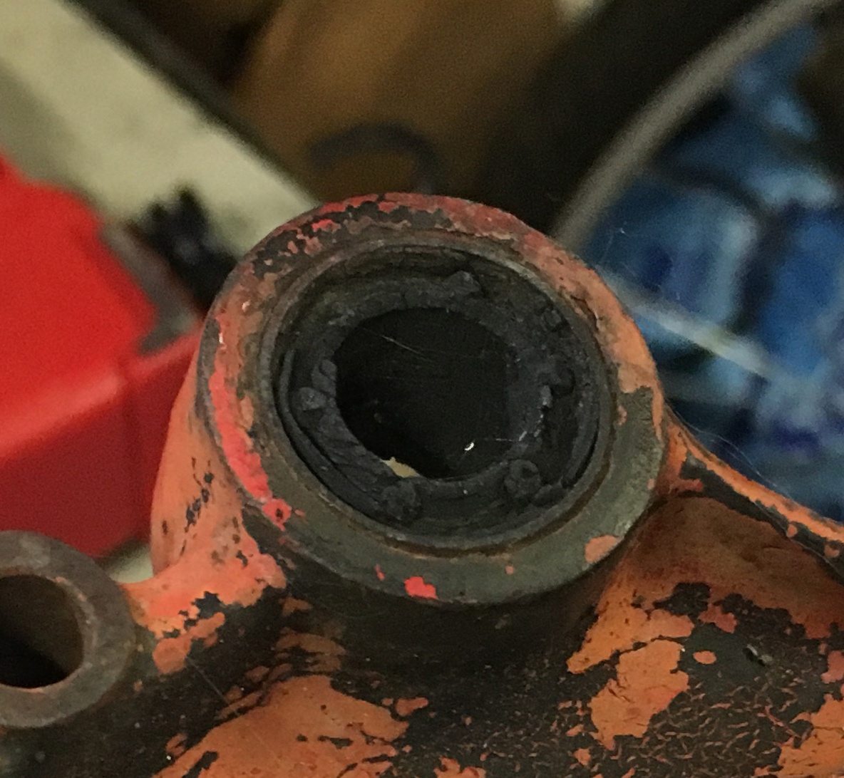

Post by Geeky160 » Thu Mar 30, 2017 4:53 pm
This is a picture of my spare CL77 swing arm. I bought some nice aluminum ones from speedmotoco for my CB160 but don't think they are the same size as needed for the CL77.Image

Post by Geeky160 » Fri Mar 31, 2017 5:45 am
I guess I need to break out the micrometer (if I can find it) and do some research.

Post by Geeky160 » Fri Mar 31, 2017 4:09 pm
It looks like these are the same measurements except the inner will need to be drilled out to 12mm. I know they are solid, I'm going to suggest they make a rubber re pop.http://www.ebay.com/itm/Honda-CB160-Swi ... Sw-CpYA6PF

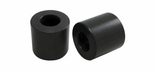

Post by mike in idaho » Sat Apr 01, 2017 7:14 pm
I've carved shock bushings from UHMW plastic rod. UHMW is a hard, self lubricating, plastic material that comes in various shapes and sizes. https://www.amazon.com/Molecular-Weight ... uhmw+1+rod I chucked a piece of rod in a lathe, bored the bolt hole then cut the od to a press-fit size. Parted off the pieces to the desired length. You might check with the machine shops in your area to see if any of them dabble in the stuff. If they don't they could probably turn out something for you, out of brass or aluminum stock.
