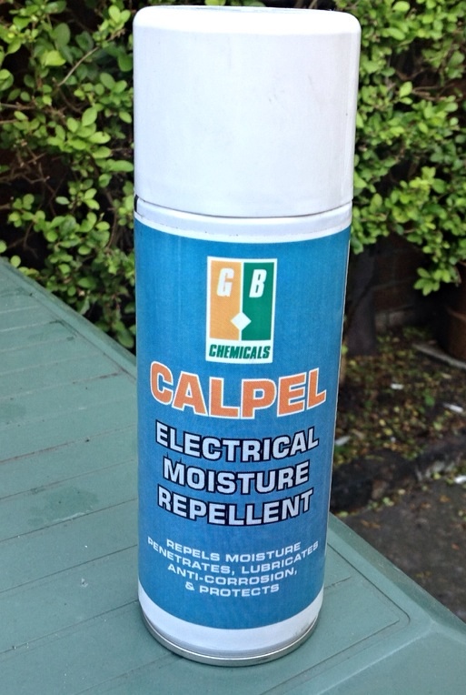

I had a BMW a few years ago that the blinkers would not cancel after being caught in a heavy rainstorm on the way to work. A guy at work told me to give the switch a good spray with this and leave it for an hour. I didn't have any issues after that.
The trouble is with WD40 it is oil based but the Calpel evaporates once it has dispersed the water. I would give everything that is electrical a good spray with this even inside the plug caps.
You certainly can't do any harm.

Will look for some of that sort of spray casamere, thanks! I have tried cleaning the points with fine sandpaper by the way.
