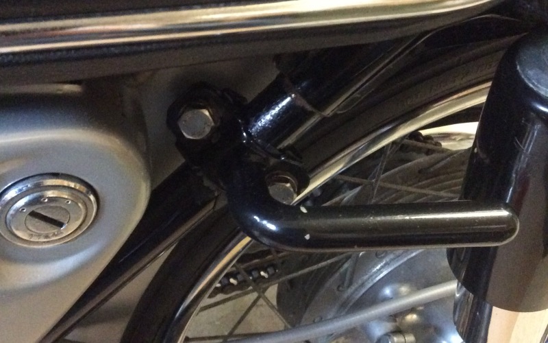

Post by Seadog » Fri Jul 08, 2016 3:59 pm
Here's today's silly question:
How do you keep the side grip/handle on the left side of the frame from moving? I've tightened it as much as I can and even put rubber tape between it and the frame, but it still rotates after putting the bike on the main stand a few times. The parts lists show some sort of packing under it, but that's long gone.
Any suggestions?
Re: Frame Side Grip (Handle)
Post by LOUD MOUSE » Fri Jul 08, 2016 7:06 pm
I use 600 grit black wet/dry sandpaper.
I cut it 11/2 inch wide then fold it with the grit out.
Wrap it around the frame tube then install handle. ...................lm
Seadog wrote:Here's today's silly question:
Any suggestions?
Post by Seadog » Sat Jul 09, 2016 7:15 am
Thanks, LM, I'll give it a try.
Edited 7/14 to add:
I tried this and it seems to be working, so far. Thanks again, LM.
LOUD MOUSE wrote:I use 600 grit black wet/dry sandpaper.
