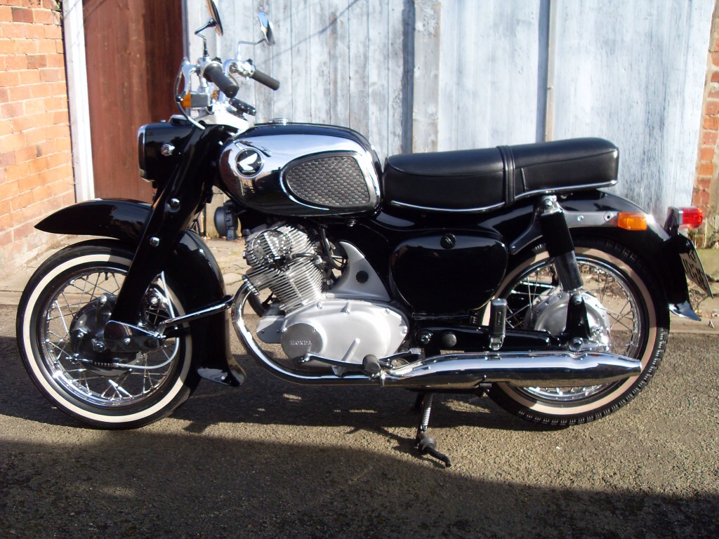

Thanks for the quick replies. I will try a different flasher. Cashmere that picture of your benly is the nicest I have seem simply pristine .well done

Robbie63 wrote:Thanks for the quick replies. I will try a different flasher. Cashmere that picture of your benly is the nicest I have seem simply pristine .well done
Thanks Robbie63 nice to be appreciated, I love it.
