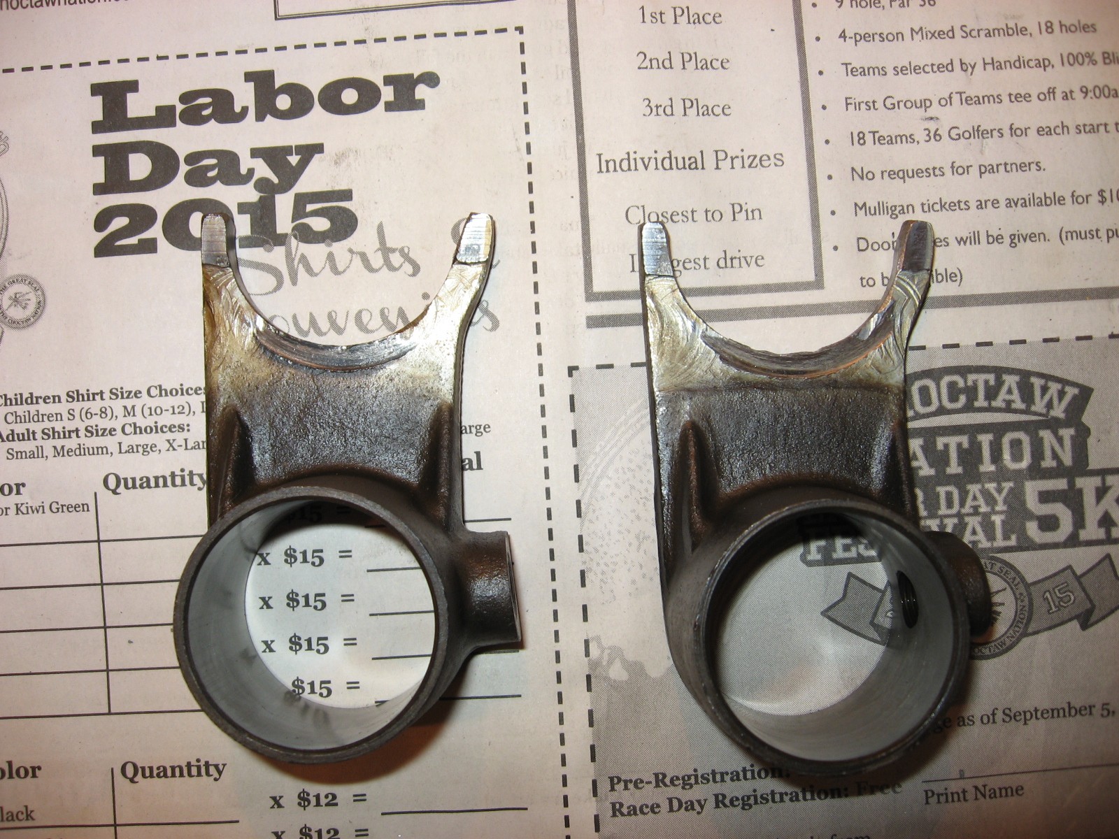

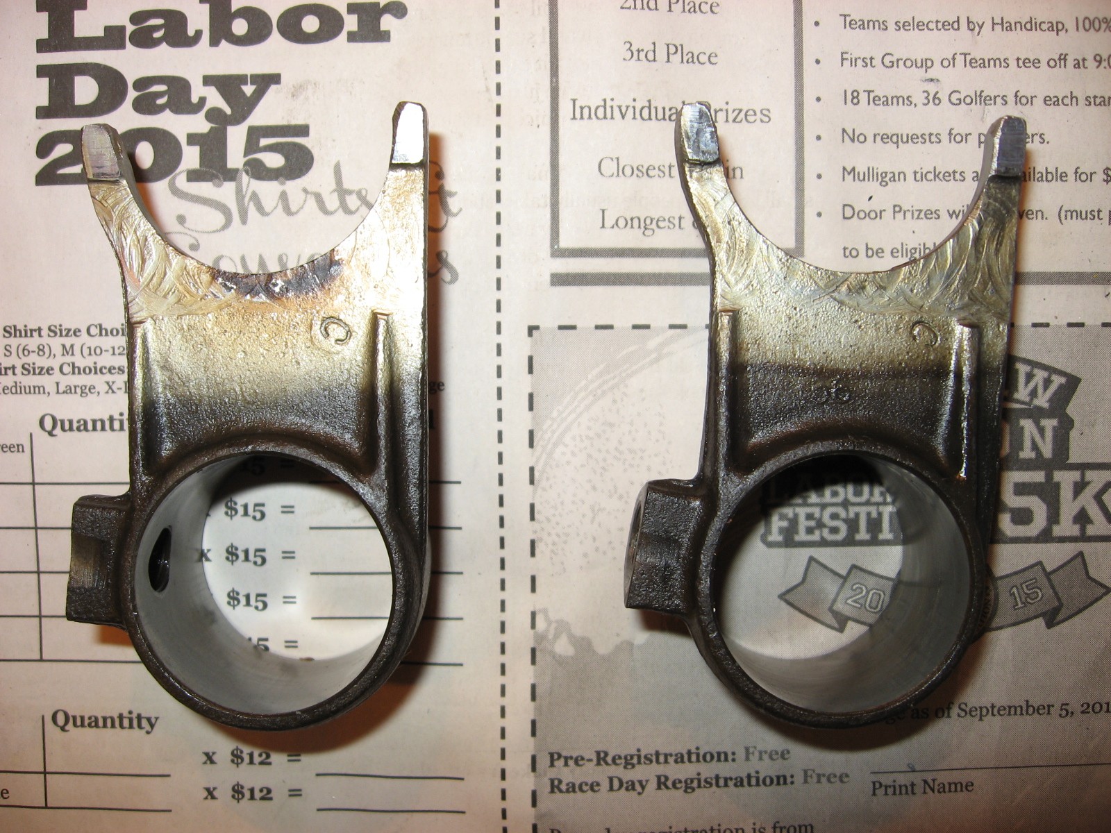

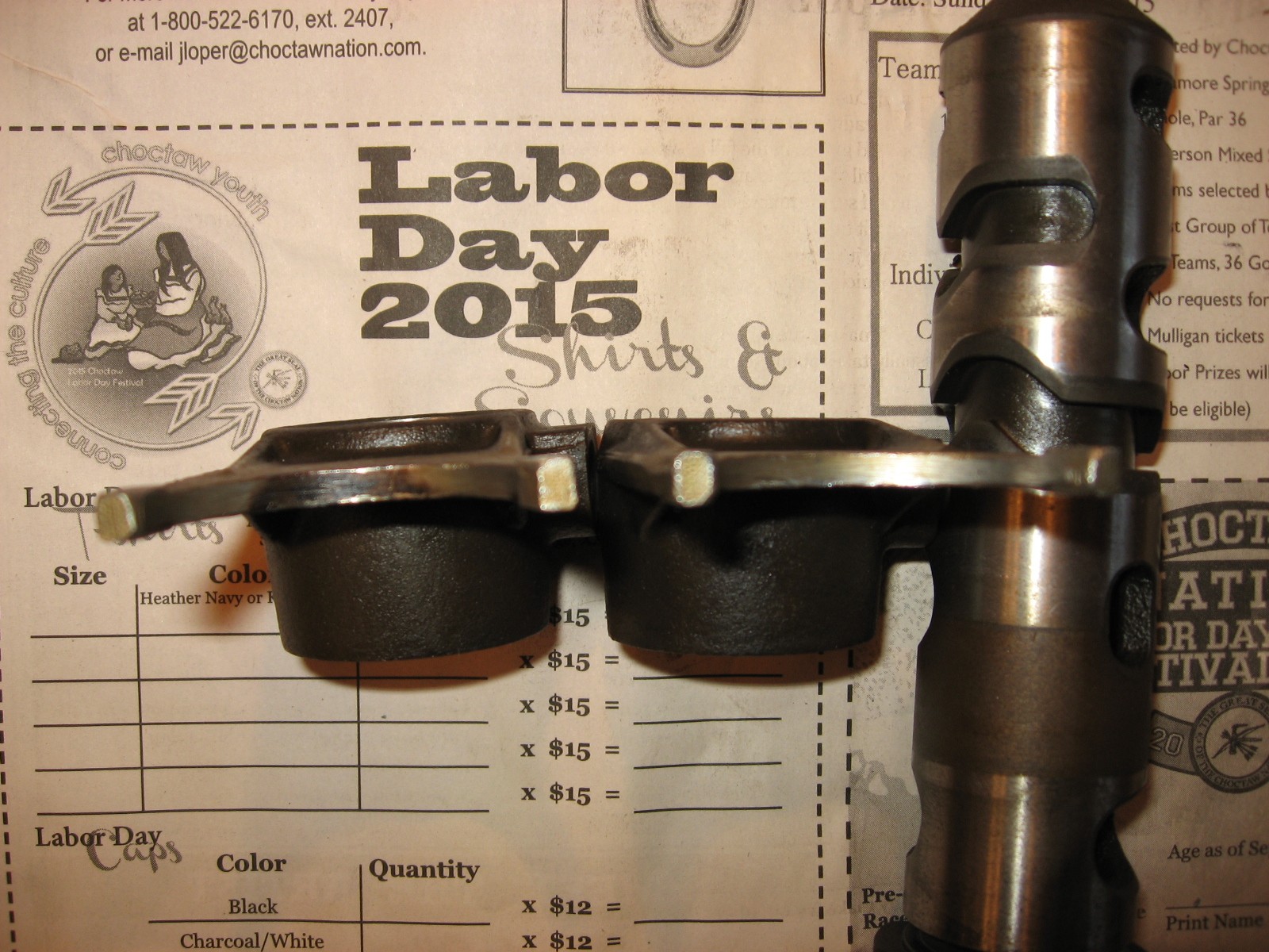

Here are 3 pictures of my forks the one on the left has a burnt spot. Is this ok? the tips are in really great shape and the gear shift drum is really nice and falls into specs easily.also the thickness on the worn areas of both,do they need to be built back up? thank you Mike

Please show the sides of the rollers and the point nearest the end of the drum. .............lm
