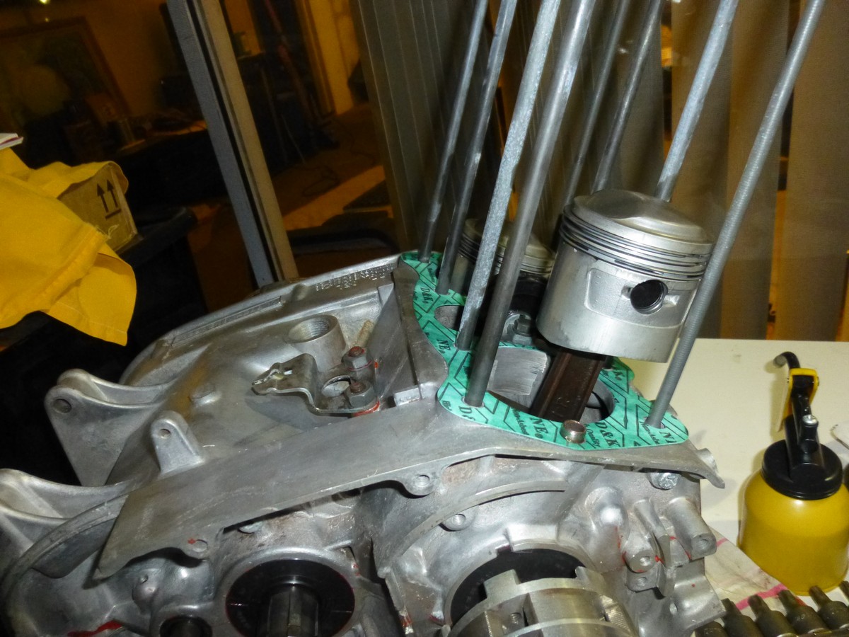

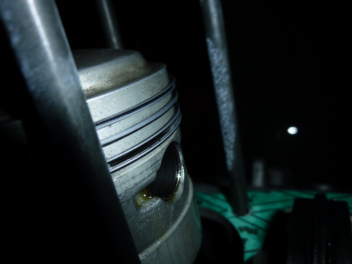

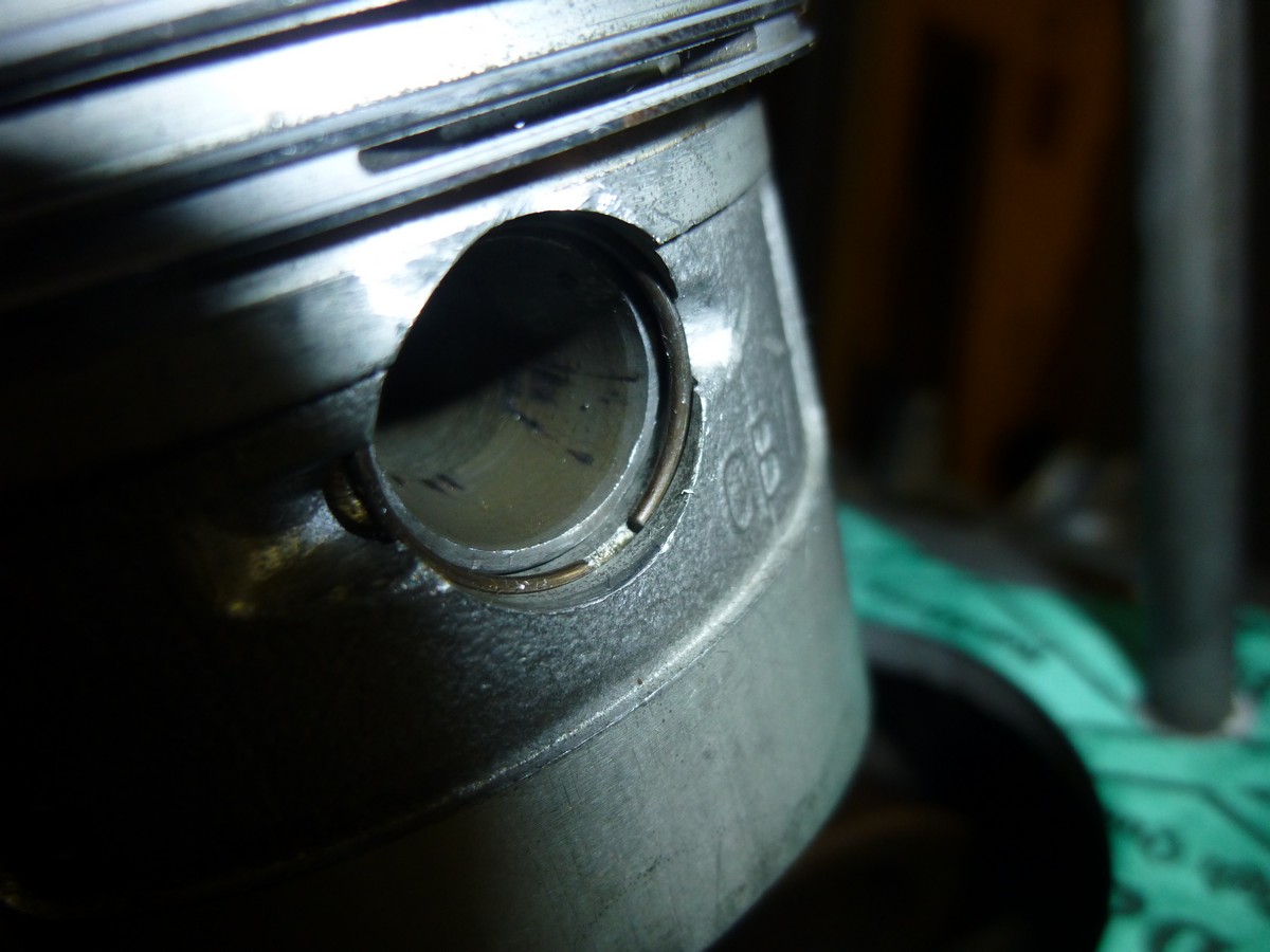

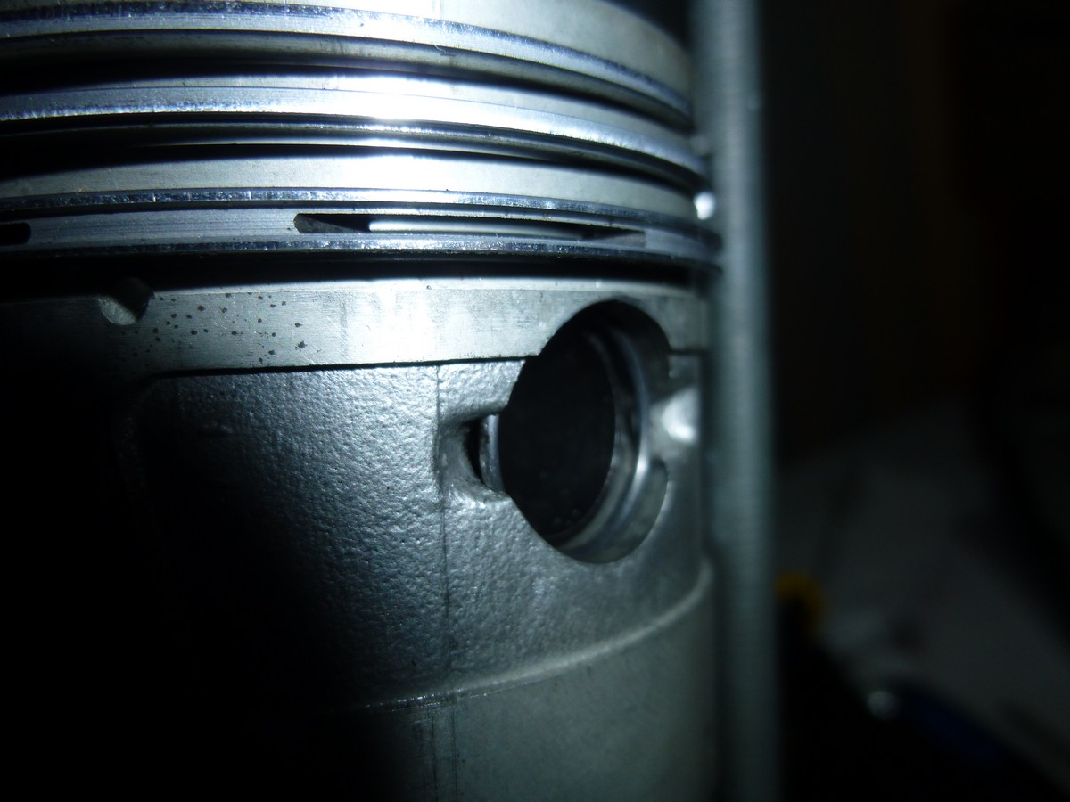

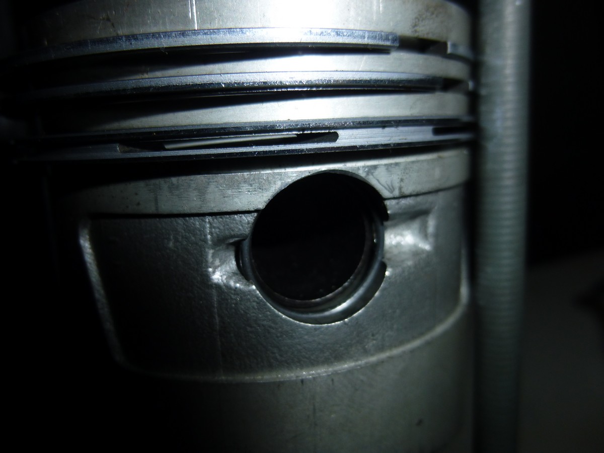

After I managed to fix some oil leaking due to the cam position failure (see my earlier post: http://www.honda305.com/forums/first-st ... 35775.html), I have a new issue: a strong smoking that I expected to disappear after a couple of mins running but it didn`t. I don`t know if it burns oil or the mixture is too rich and that is the reason for the smoking. The mix is rich for sure, because it is not running when the choke is on. The carbs are rebuilt with aftermarket kits, the float valve is set to specs. The ignition and cam timing is correct. The oil rings are supposed to be sealing, they looked new when I assembled them in and the gaps were within the specs. I attach some pics about the pistons and rings that I made when I put the engine together. Since these engines don`t have valve seals, they should be ok, too. Any guess where the smoke is coming from? Another, perhaps related question: where is the breather pipe on the cylinder cover supposed to be connected to? I couldn`t find any inlet on the air filter. Thanks for all comments, any thought might be useful, I really hope that I don`t have to pull apart the engine again.

Just curious if you set your ring gaps 120 degrees apart from the others? Your last picture shows the top compression and second scraper ring gaps almost in line.

Yes, I positioned them 120 degrees apart. Thank you, now it is clear how to route the breather hose.
