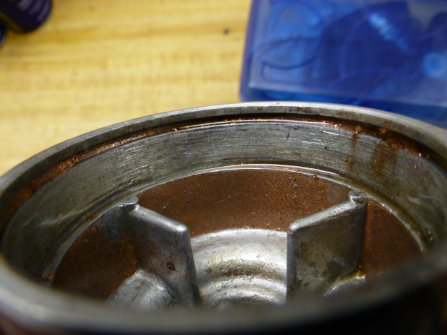

I've put 785 miles on it since the original post. I went on an AMCA Road Run in Yosemite, a lot of 3rd gear over several major mountain passes (over 9000 ft elevation) along with a few other smaller trips. Pulled the filter and this is what you see. I haven't noticed anything unusual in the operation of the transmission. I'll continue to monitor the situation.

Have you removed some of the stuff and are sure it is brass?
A side knot is now we no longer have leaded gas the oil sure doesn't carry a lot of debris. ...............lm

I cleaned it out,seems to be brass, non-magnetic, all very fine stuff, nearly a paste. From the color not sure what else it could be.
Is it the lack of lead or the better additives that makes it cleaner burning?
