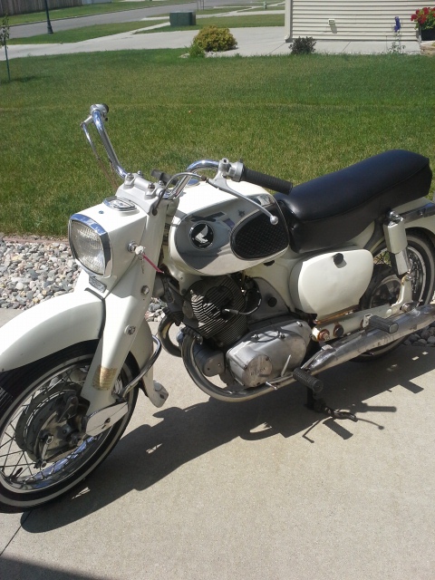

Thank you for the reply, the information is very helpful and I will work on the gearbox when I have time. Sounds like a big project. I do not think it is the clutch, the other three gears work just fine. I think when the bike was young somebody had a lot of fun. The rest of the bike is in pretty good shape for its age.

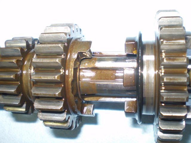

The picture below shows some of my gears. The teeth are great, but notice the slight rounding of the dogs on the center gear. Replacing that gear fixed my problem. Strangely, the dogs it meshed with were still OK.

Larry has the correct diagnosis I think. I'm surprised that the teeth are worn after such low mileage though. Maybe the heat treating/hardening was not correct during manufacture. Don't forget when you you rebuild the tranny that there are offset cotters available to maximize dog engagement. Lifting the bike upside down is clever, but you will need a couple of strong mates!
