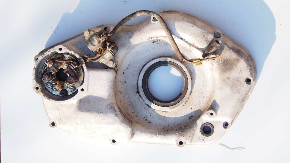

I acquired a CR72 primary cover a while back to look at how it was done by Honda back in the day. This one came up on UK eBay, rather surprisingly. It won't fit a CB72 engine but is very interesting.....

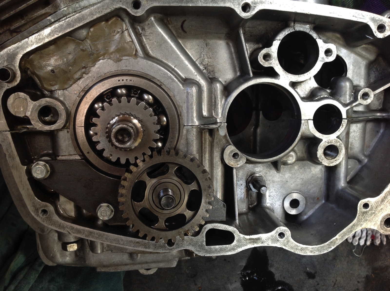

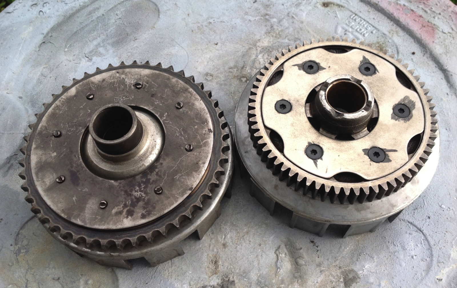

The other pictures of a gear primary conversion using a CB500 clutch drum with gear and the idler gear (actually a gear from a Honda gearbox) with mounting plate.

That's the plan. Typically Honda, all of the screw holes are in the wrong places, despite the fact that the original CR72 was based on a CB72 design. Last month I picked up a CR72 gear shift lever and linkage with some CB72 stuff so I'm edging ever closer.
It should be possible to come up with something based on that cover for a CB72. There have been a number done like the one you showed and Ellis Holman's. I think there is also something on Michael Moore's Eurospares site.

hillhudson wrote:Oh man, thanks for the info! It might be nice toget that primary cover molded and replicated!
