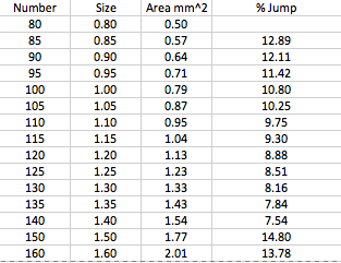

If you have good facilities you can just drill out the jet with a 1.4mm drill. Don't forget to re-mark it though.....
Keihin jets are just numbered using the diameter rather than the area / flowrate like Mikuni or Amal.
Screen Shot 2015-04-10 at 11.23.27.png (11.53 KiB) Viewed 3846 times
