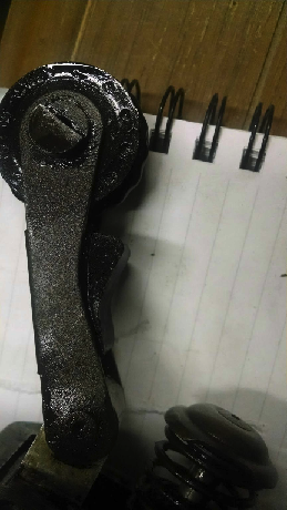

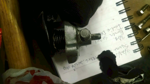

Here's some pictures.
One is showing how loosely and awesomely the spring can contract, it's in fine shape.
But roller wheel looks pretty dull and that triangular plastic is dipped really hard.
