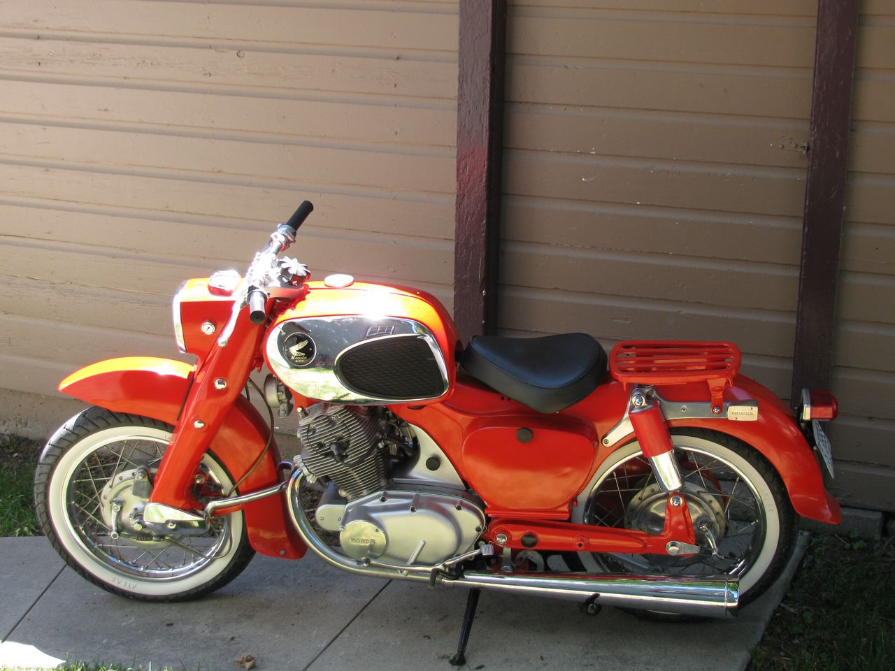

Does anyone knows if the CA77 Throttle, Clutch and brake cables will still work/fit if I convert it to to flat handlebar like the CB77, or they will be too long to fit right?

I really like the style of the bike with the flat bars on Jethro's bike. (See attachment)
Jethro's CA77
Jethro's CA77
Post by G-Man » Wed Dec 31, 2014 12:49 pm
Unless you're going to tie knots in them you probably need CB77 cables..... :-)

There will still be the issue of a throttle cable and throttle. The CB cable is a dual cable. The CA throttle is the slide type.
Post by G-Man » Wed Dec 31, 2014 5:04 pm
I think I would go for a throttle and cable off something like a CB100 or another Honda single....

I am running drag bars on mine which I cut down and converted to accept the stock throttle. Running into the same issues new cables wayyyy to long now. Plenty of videos on how to shorten them on youtube which is what I will be doing very soon. Looks very simple. Good luck and post some pics when you are done.

Can anyone tell me who owns the bike in the picture shown in this posting?
