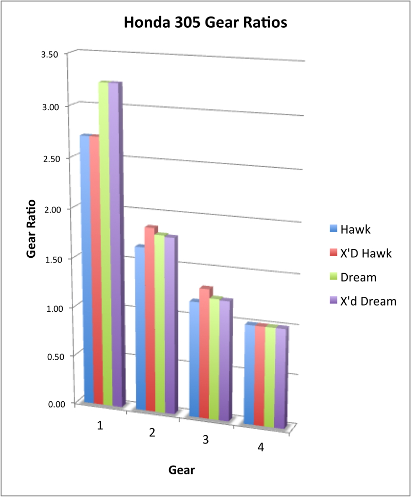

Post by G-Man » Sat Dec 27, 2014 4:45 pm
The way of evening out the steps in the transmission is to "X" the 2nd and 3rd pairs which gives a better spacing. If you want to reduce the revs in top gear you need a smaller rear sprocket or a bigger front one.
My picture shows the effect of X-ing 2 and 3. The Hawk and scrambler use the same ratios.

G-Man, According to you graph my gear sets are right. I just can't beleive that 45 years ago I rode around with the engine screaming at that high of an RPM, but hey I was just a kid. Is X ing having to do with shims?
