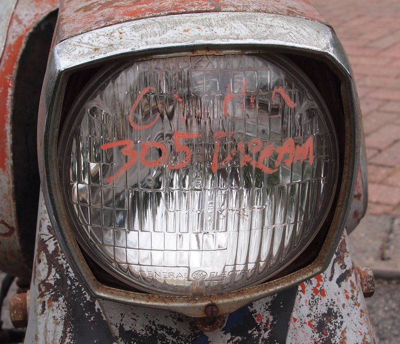

My Dream is a daily driver so I'm not too worried about 100% originality. So, when both the high and low-beams of my Dream's headlight finally burned out — after giving years of reliable service — it was time to find a replacement. Since I only paid $150 for the bike there was no way in heck I was going to pay the crazy prices being asked for a NOS (or made-in-Thailand fake NOS) unit. Not me! So I just went down to the local auto parts store, picked up an automotive sealed beam along with a universal connector to connect to the three prongs at the back of the headlight. Total cost: about $12.
I then cut a small frame from a piece of plastic that was square on the OD to fit the Dream headlight frame, but with a round ID to fit the headlight and made a few clips to hold it in place Then solder the Honda wires to the universal connector and...viola, great lights again.
Nothing very original here, of course, but a very practical and affordable solution for those who don't want to get ripped off.

Painting the home-made frame with 'chrome' paint would be better but all I had was silver.

That looks pretty good Nick!! Even the silver paint looks good!
