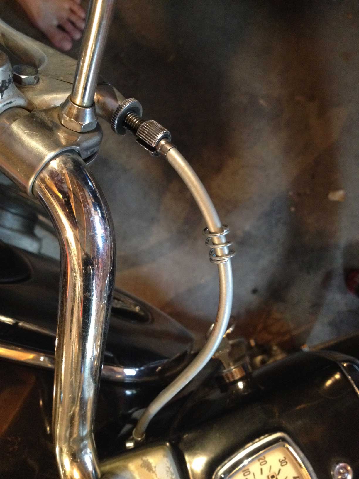

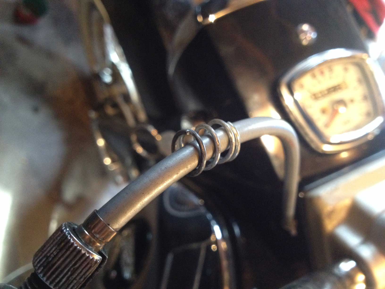

Just installed my NOS clutch cable and wondering what the little spring is for?
The original cable did not have a spring, but it had also snapped so the spring could have possibly fallen off at some point.
The bike is running & driving but the clutch cable feels a little sticky when pulled all the way in, you can feel a physical click as its pulled in.
Does anyone have an image of the correct routing for the clutch cable?
Also neutral is hard to find.
Any help would be appreciated.

Post by Londonluke » Sun Aug 24, 2014 6:43 pm
I will be working on the bike this week. Once the left cover is off I am sure it will make more sense.
Here is a picture of the spring I referenced previously.
Thanks again.

Post by Hoosier Tom » Sun Aug 24, 2014 10:40 pm
I believe that spring is for the star type adjusters, part number 53192-205-000, used into 1963 up to frame CA95-3104263. You don't need it for the type of adjusters you have.
