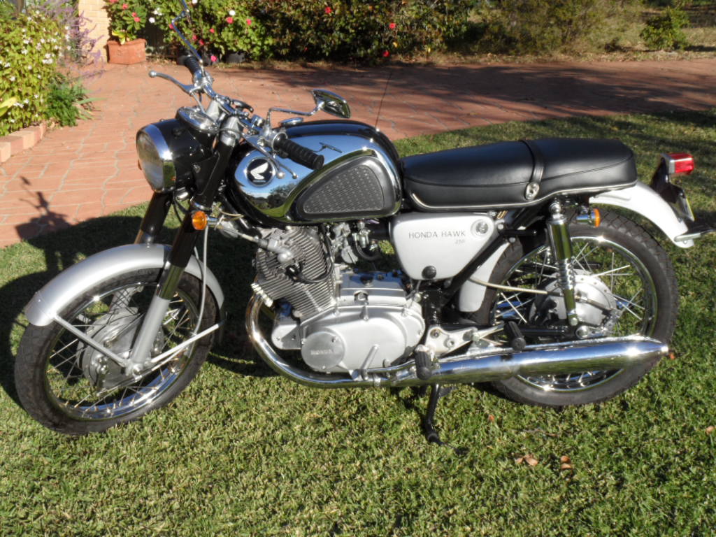

Hi Guys, Thanks for all your replies, I tried them all with no success, as a last resort I wrote to Mr Honda, Bill Silver, he advised me to check on the cutaway, as the slides could have been swapped over, the cutaway should face the Air Filter, low & behold he was right, they had been swapped over. The Plugs don't burn up any more & turn black.
I think the Carbi: needs some fine tuning, I tied taking it for a ride,the bike hesitates & tries to cut out. The engine has been warmed up for about 7 minutes, so that could not be the problem
The jets in the Carbi: are 35& 100 &the needle is set at the middle cut, I tried dropping it one with no change in take off. Thanks for all the concern, Regards, Gordon.
Ps Attached is a Photo of the problem Child,
- SAM_1589.JPG (171.88 KiB) Viewed 4954 times
