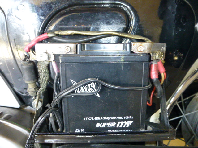

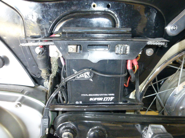

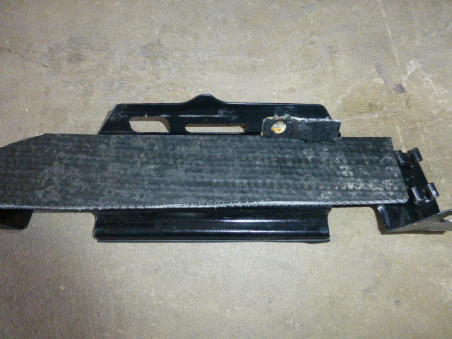

Post by OldStan » Sat May 10, 2014 9:23 pm
OldStan, any chance you could show us your adapter and rubber fittings? Seems like this battery is a no brainer, but would love to see how to seat it comfortably in the housing.
Just got a chance to take pictures. I used an old truck mud flap for the rubber. The brackets were cut out of a piece of square tubing. Notice the right bracket is bent back slightly for clearance.
Now I'm looking for a narrower version for my CL77.
