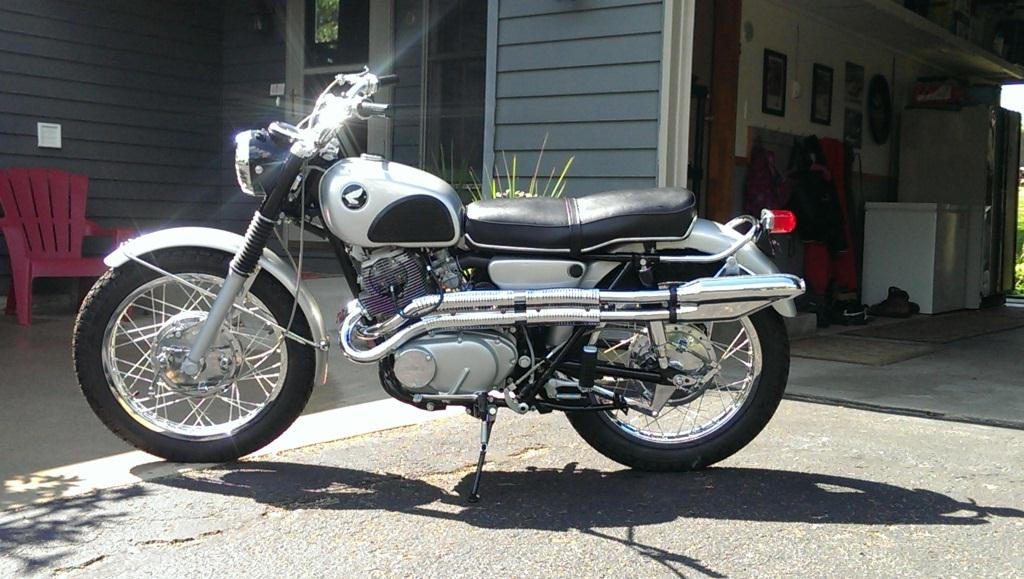

ok guys, I have my restoration on the restoration files but this is a separate carburetor issue so I thought I would post it here. A little background---bike was taken apart fully, valves taken care of, new rings, and cylinders honed. I also put in new carb kits and quite honestly that might be the issue but let me ask you. I worked with Ed and finally have the timing set up as it has spark and when I finally got it started it runs for maybe 5 to 10 seconds and then shuts off. I choke it to start and try and wait for it to warm but it won't run long enough for that to happen. I tried giving it gas after running but it dies right away. I am thinking it is a carb issue because to me it can't be getting enough gas because it chokes out once the cylinders run out of gas.
Remedies anyone?
Bike won't stay running
