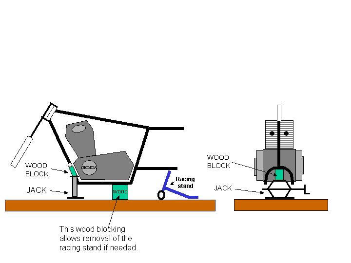

Good question, LM. I assumed everyone has their own way to jack/support the bike. But it can be tricky due to the balance points of the bike.
First, I use a lift table from Harbor Freight. Too old to bend over and still smile all day.
I use a racing stand on the back swingarm to give the bike a solid and stable base. I put a strap on both sides from the frame to a tie downs on the lift. Straps are vital for this. I also put two straps on the handlebars down to tiedowns on the lift so I end up with 4 points (straps plus another 3 (jack and racing stand) as the support for the bike.
The front is the tricky part to lift because the CG of the bike is just about anywhere under the engine. By that I mean if you jack anywhere under the crankcase, you end up lifting the entire bike.
So, I cut a small piece of 2x4 that slides up under the curved yoke at the front of the frame where the lower portion of the frame meets the front downtube. Of course, skid plate is removed. The block is cut at an angle so that when it lies flat against the front of the crankcase, the bottom of the block is parallel to the surface of the lift table to provide a horizontal jacking surface for the jack.
I suppose you could use the center stand instead of the racing stand, but my bike had a 4.00 rear tire (to be changed back to a 3.50) which made the stand too short to use for this. Plus, the stand could fold up on you, if you ever rocked the bike fore and aft and that would result in major heartburn.
Attached is a sketch showing both side and front views of how the block is positioned. Block is shown outside the frame tube just to provide a view of how the wood block is positioned.
I've since removed the racing stand so I could work on the swing arm. I jacked up the front of the bike with the jack as shown until I could put a stack of wood blocking under the engine, towards the back of the bike. I then lowered the front back down and the bike came off the racing stand and onto the wood blocks so I could then remove the stand. This is how I was able to remove the swingarm. Block is shown in the same attached sketch should somebody want to do this.
A note regarding jacks. I use scissor jacks with a wide plate welded to the base for added stability. I would not use a scissor jack without such a baseplate because it is too easy for the bike to fall off the jack.
regards,
Rob
