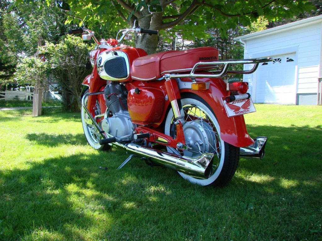

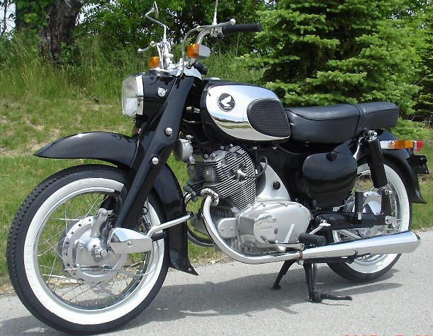

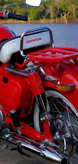

Brad, most European- and Canadian-market models would have had them, as did our C/CA92/95/160 with the same r/h switch/throttle ass'y. Post pics of your lamps, please. What type of throttle grip do you have -- the type with the sliding 'hinge' in a slot in the handlebar?
Later rear winker mounting
Shows later type rear winker mounting
Early C77 rear winker mounting

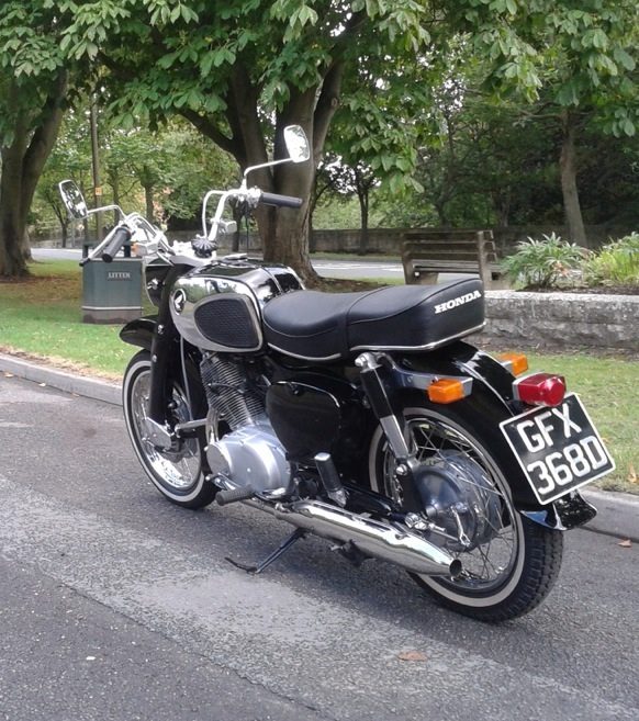

casamere
Posts: 379
Location: yorkshire UK
Post by casamere » Mon Nov 30, 2015 2:57 pm
My CA77 with winkers that I fitted as I wanted it UK spec with correct handlebar switch from e bay but not cheap.
