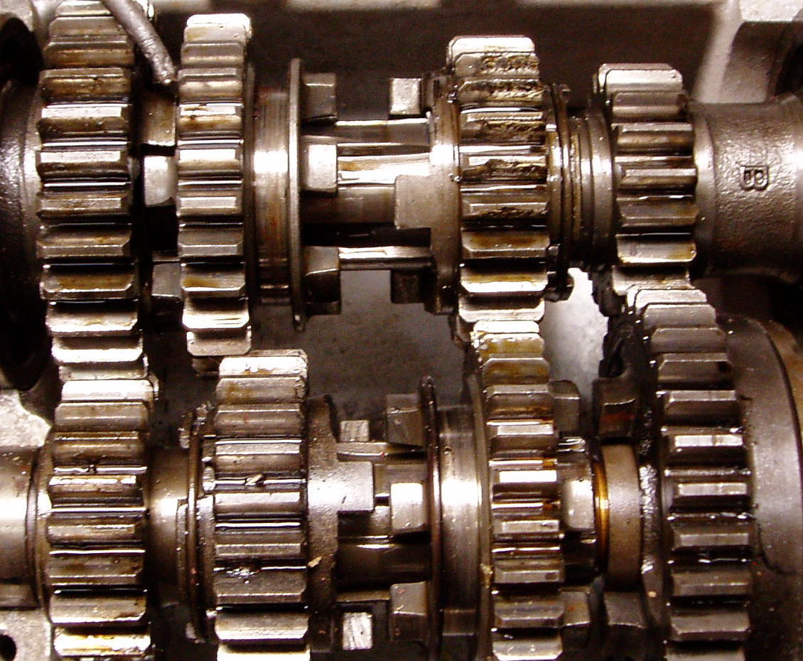

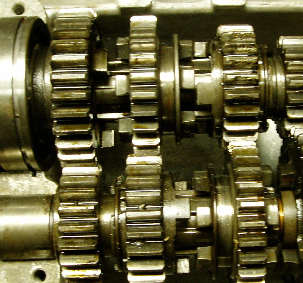

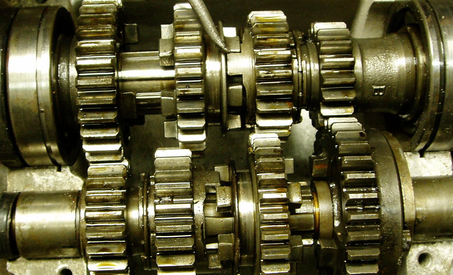

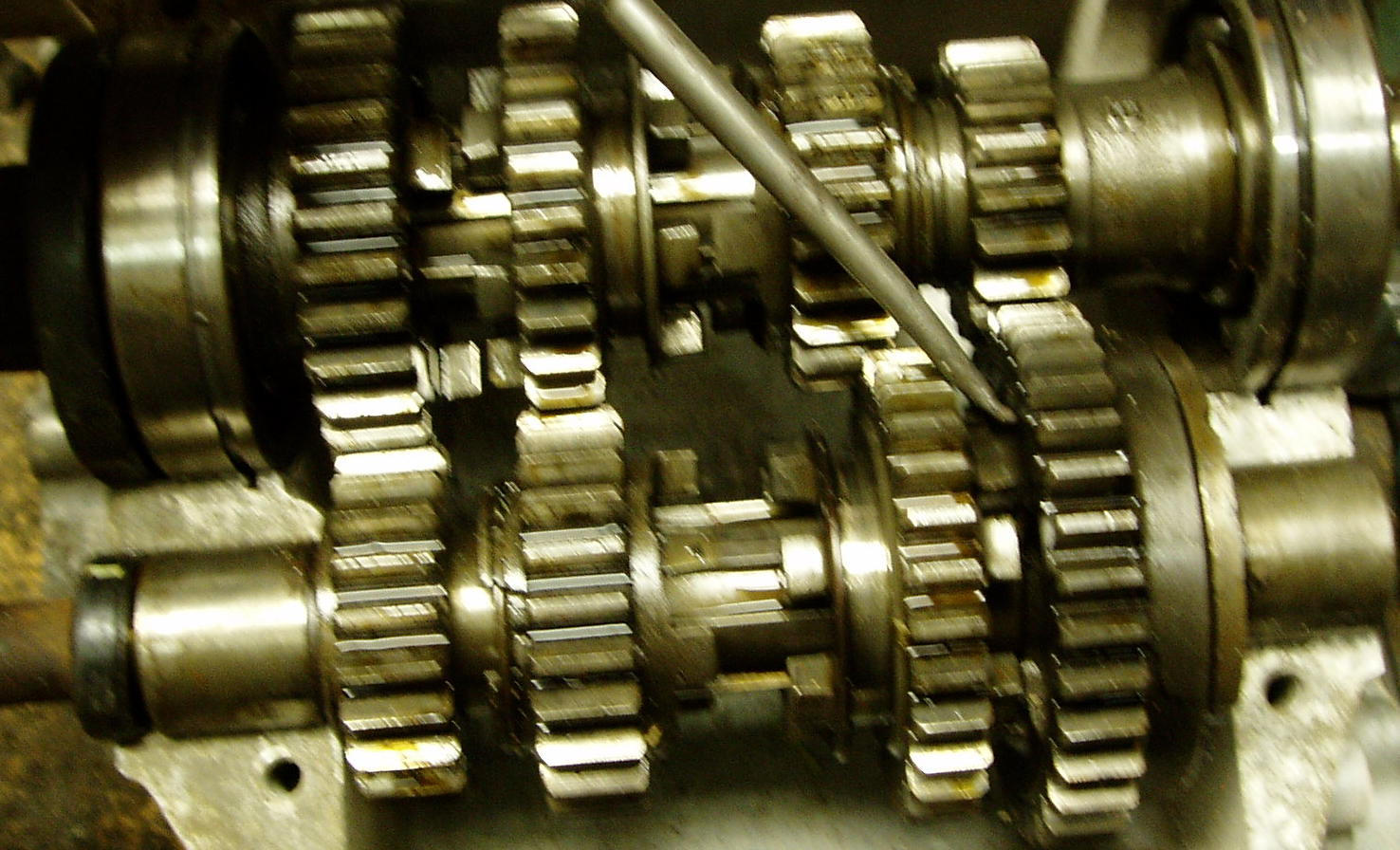

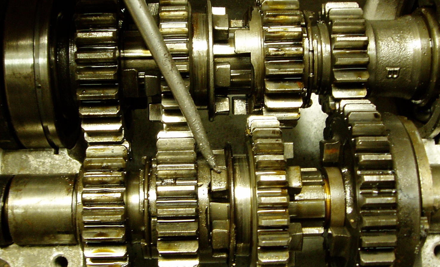

gears
OK, as promised.
Note the pointer in each showing the dog engagement in each position. Note that the dogs have an under cut bevel to draw them together when under pressure. I'll make points of interest for each. Hope this helps and if you need to, PM your # and we can talk. RW

Rusty Wrench,
THANK YOU SOOO MUCH!!! (sorry 'bout the caps, but I wanted to yell it)
I took the pics and tried to replicate it on my trans. I even put the shift drum back together an put it in place so I could change gears using the drum and get a better visual. Had lots of little "awe" and "oh" moments and a few "huh?" moments too, but I think I'm getting it slowly.
I think it'll work better when I replace the broken cotters and such but I'm trying to give it a little wiggle room to make up for them.
Thanks again, You're the man!!!
Joel
Joel

Joel,
The most important part of the assembly is to insure that the dogs engage fully. Otherwise you could end up with jumping out of gear problem. Offset cotters can help that some but not always needed. IMHO, if you are going to put together a race machine or one that is going to cruise at super insane speeds, I personally would not go to the extra effort to shim one of these things to micro specs. For our toot around town occasional riders, close is OK. Others will surely argue with me but that's just MHO on the shimming thing. X'ing is a good thing to do for a better ratio and very simple to do. Later, RW
