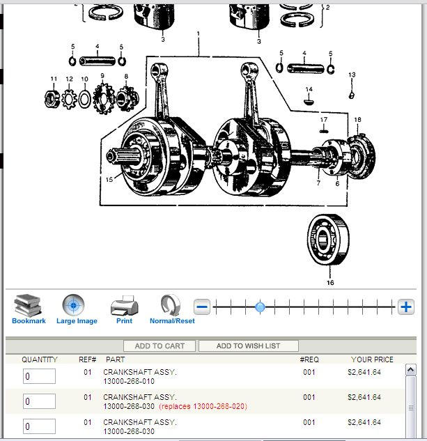

I guess you've seen for yourself, but what I find odd is the difference in price between the CB72 & CB77 crankshafts (see below screenshots); alarming! I can see no earthly reason for that, nor can I think of one for why they'd be different items between two, essentially-similar (similar being the keyword, I s'pose) and identically-stroked motors, but they do have different part nrs -- and 3 different part nrs per model. I'm sure Ed (LM), Jensen or another member who owns / has owned both models may have something to add.

Sorry I didn't spot the prices until I enlarged the scans. Ouch!
Yes strange that the CB72 was so much more expensive.
I cannot imagine a reason. Usually changes happened on both.
