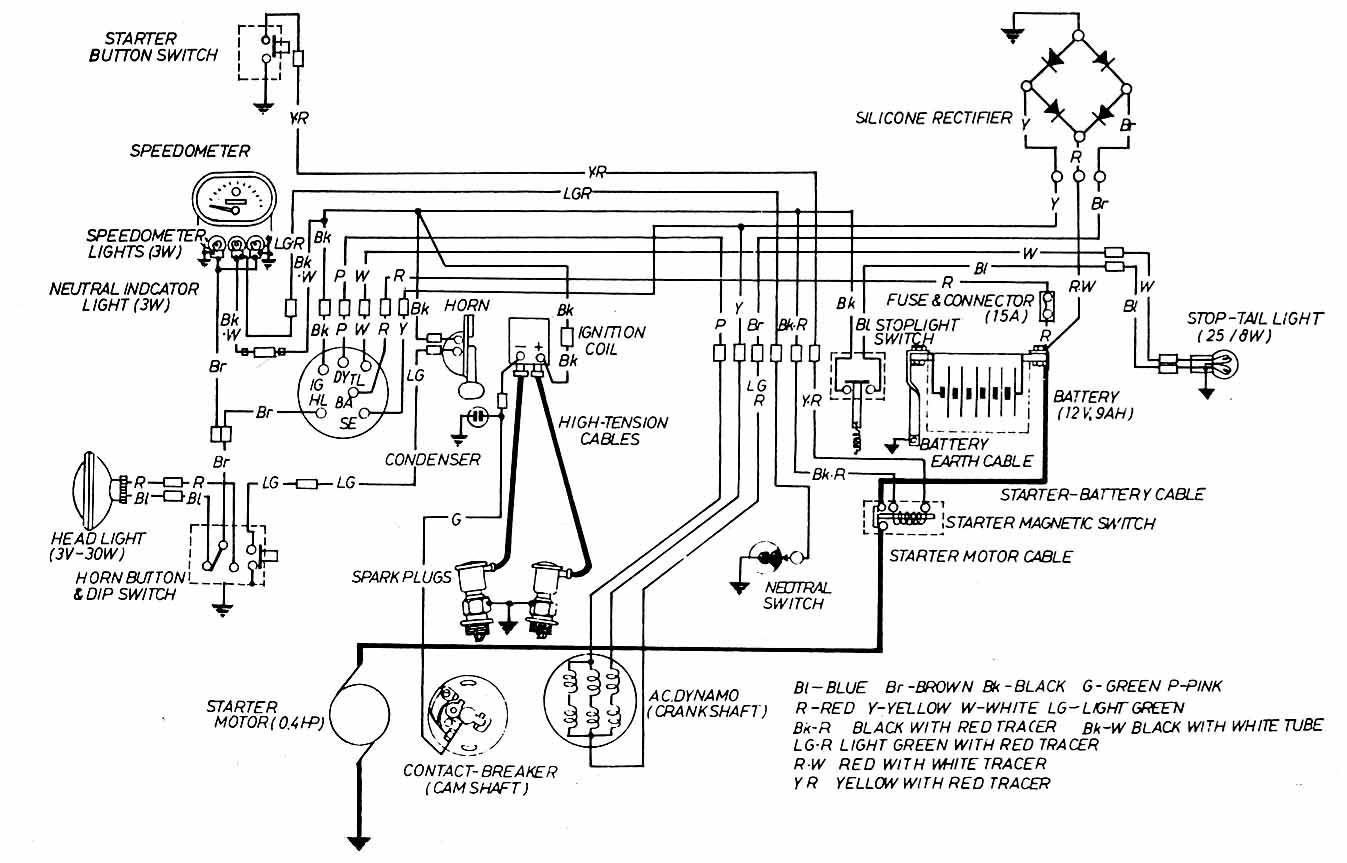

I have a 64 cb160 cafe project but i am fairly sure the wiring is the same as the 305. here's my problem: i had to replace a bum ignition switch, but all the stock NOS stuff was over 100 bucks. so i opted for the universal 3-position switch which works fine, only problem is there are 4 wires coming off the new switch (black, red, brown, brown/white). the original had 6 wires (black, red, brown, white, pink and yellow) and 4 or 5 positions.
i removed the left hand controls (horn and headlight hi/low switch) permanently. i am only looking to have everything power up when the switch is in position 1. i will install a toggle switch for the headlight so it is not always on. can someone tell me which wires need to be excluded or re-routed to make this happen? i am pretty rookie with electric but trying to learn.
attached is wiring diagram for the bike.

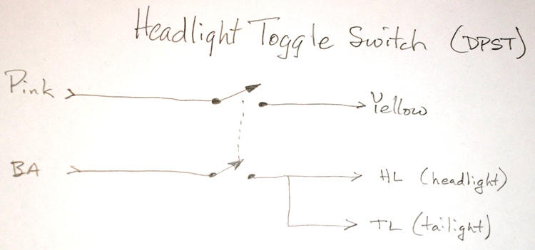

When you toggle your headlight 'on', you will also need the toggle switch to connect the pink (DY) wire to the yellow (SE) wire so that the generator will put extra power into the charging circuit to make up for the power drawn by the headlight.
That toggle switch should also connect the white (TL) tail light wire to the brown (HL) wire so that your tail light is on when your headlight is on.
I think you could accomplish this with a DPST (double pole, single throw) toggle switch.

I think the headlight wiring can be done with a DPST (double pole, single throw) switch. The way I am envisioning it, one pole will connect the pink to the yellow when the switch is toggled 'on'. That covers the generator.
The second pole, when toggled with the headlights, will connect both headlight and tail-light to power.
I have assumed that because crispy is saying he is permanently eliminating the headlight dimmer switch that he is intending on wiring directly to one or the other headlight filaments (either high or low beam, but not switchable).

Mostly, yes. But I've been studying the 160 diag and it seems to differ in the combining of the lighting and ignition switches. CB72s/77s have a separate lighting switch.
crispy wrote: here's my problem: i had to replace a bum ignition switch, but all the stock NOS stuff was over 100 bucks. so i opted for the universal 3-position switch which works fine, only problem is there are 4 wires coming off the new switch (black, red, brown, brown/white). the original had 6 wires (black, red, brown, white, pink and yellow) and 4 or 5 positions.
I'd say, logically-speaking, the OE switch has 4 positions: 0-OFF -- 1-IGN ON -- 2-IGN & LIGHTING ON -- 3-PARKING (tail)LIGHT
crispy wrote:.... i removed the left hand controls (horn and headlight hi/low switch) permanently. i am only looking to have everything power up when the switch is in position 1.
Why? How will you operate the horn and switch hi/lo beams?
crispy wrote:.... i will install a toggle switch for the headlight so it is not always on. can someone tell me which wires need to be excluded or re-routed to make this happen? i am pretty rookie with electric but trying to learn.
Wilf is right on the money with his freehand diagram. Your OE switch would have connected thus:
  • 0 no connections
    1 BA(Red) to IG(Black)
    2 BA to IG maintained, HL(Brown) & TL(White) added and, separately, DY(Pink) to SE(Yellow)
    3 BA to TL
To achieve your requirement follow Wilf's drawn-up advice.

Incidentally, the w/d incorrectly states that the headlight is "3V - 30W" instead of 12V. And the grounding connection is missing!

Wilf, I am agreeing with your idea about the DPST, but suggesting that he cannot arbitrarily remove the dip switch and horn switch.
