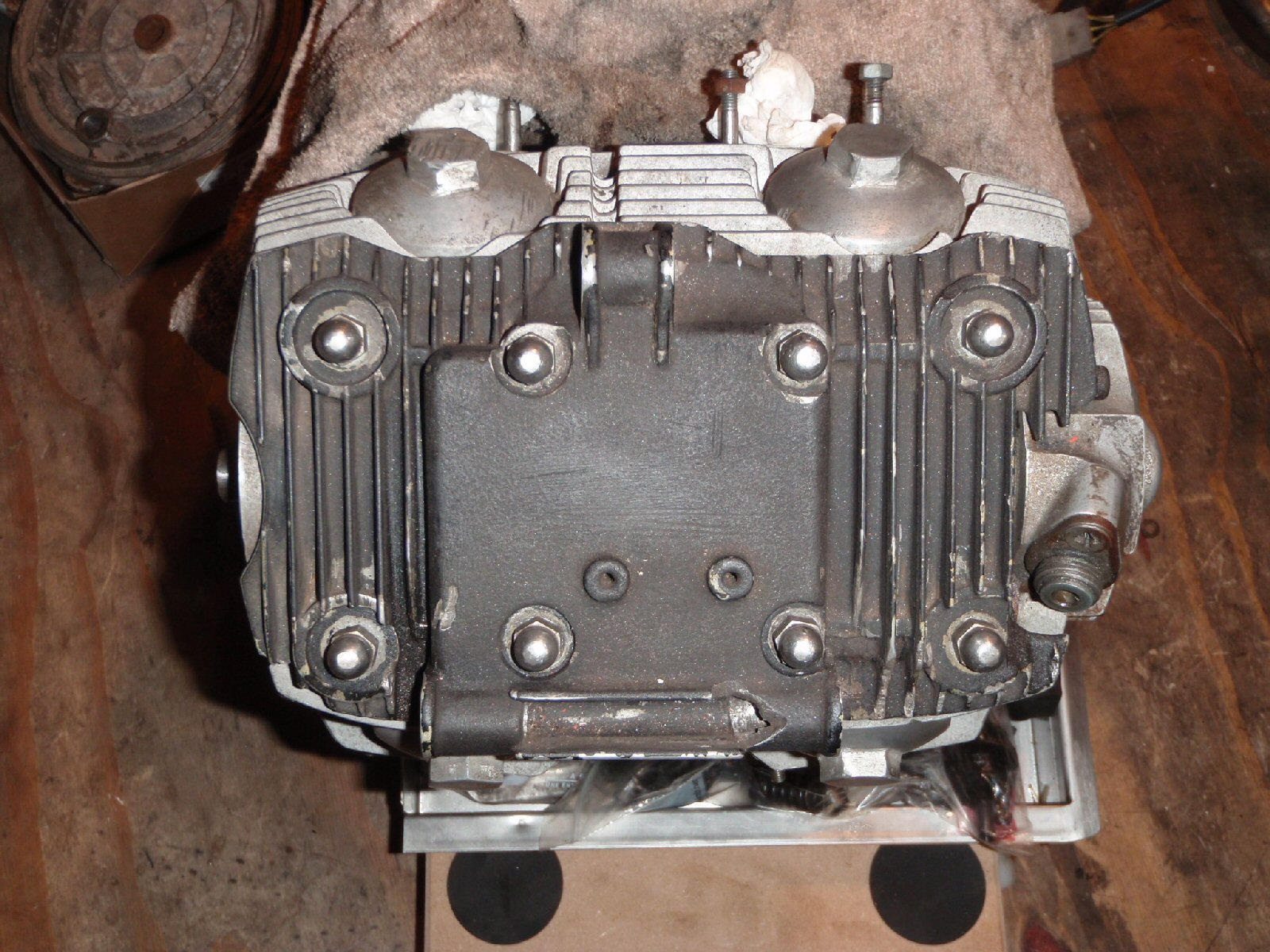

Hi,
any idea ?
Jensen
any idea ?
Jensen
Re: one for the specialists
This is from the very first engines with the case breather.
I have a NOS/OEM one here that isn't broken.
The location for the single points condenser makes me think it's from a C/CA72/77. ..............lm
jensen wrote:Hi,
any idea ?
Jensen
I have looked at mine and I think it is from a 61 CB72 tach drive and all.
It isn't tapped/no threads for the 360 crank single points condenser so as HONDA always (bikes to USA) mounted the condenser to the right side coil mount I'd say it is for the 1961-- 180 crank, case vent engine.
How many holes at the bottom of the cylinders?. ...............lm
jensen wrote:Hi,
The engine and the cover are CB72,
but from what year ?
Jensen
