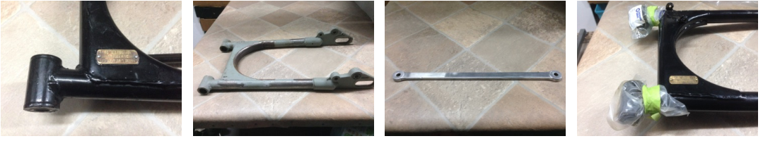

A couple of swing arms with the ID plates and a very early swing arm with the passenger foot peg attachment.
Early aluminium brake stay, longer than normal but I don't have an early brake plate. Looks like they went to standard brake stay and brake plate, but with early actuator arms fairly quickly in production. Early forks somewhere.

Thanks. All interesting stuff. What are the mods on the flat track frame?

I have a 'short' alloy brake stay if that would help you......
