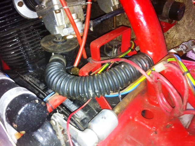

The Cappelini breather is neat but I just used an adaptor made from an old dipstick and fitted a 1/2" bore hose onto it, you'll need a catch tank if you are planning on getting near a race track today as well as a 'shark fin in front of the rear sprocket. I think an oil containment tank under the engine is pretty well compulsory now too.

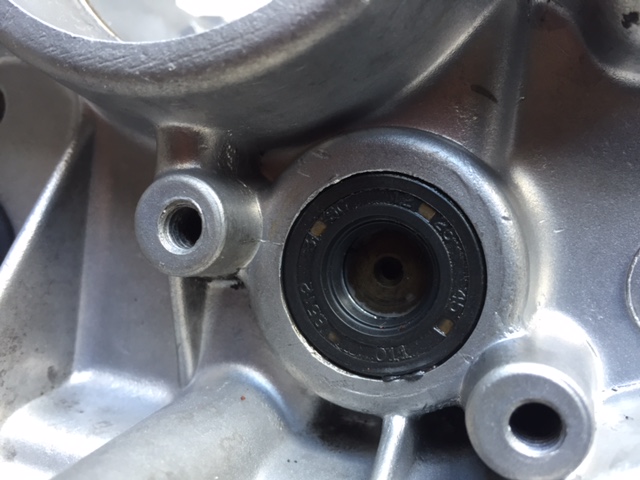

Part number for the neutral switch blanking plug is 91204 KV0 000, I think it's originally from a CB200 but it fits perfectly and does the job.
Good luck with the rest of the restoration,
DJM
Just picked up a blank from Ebay...Only one on there. looking on Bill Silvers site it is discontinued part. Lucky to get one I think. Thanks for your guidance on this.
The breather has been adapted to connect to the frame, so no need for a catch tank. Pic attached.
