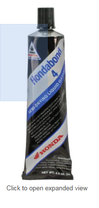

Hey Fellas!
I've been in a lull on the bike for a while now unfortunately. Had a couple art shows, moving, and not enough funds to continue but now I'm back at it! Ordering the cylinder sleeve and Honda bond to get started on rebuilding the engine. Just want to make sure this is the right stuff because apparently there are a couple different types of HondaBond...
Post by LOUD MOUSE » Tue Sep 15, 2015 12:25 pm
That's the correct sealer for the cases. .............................lm
