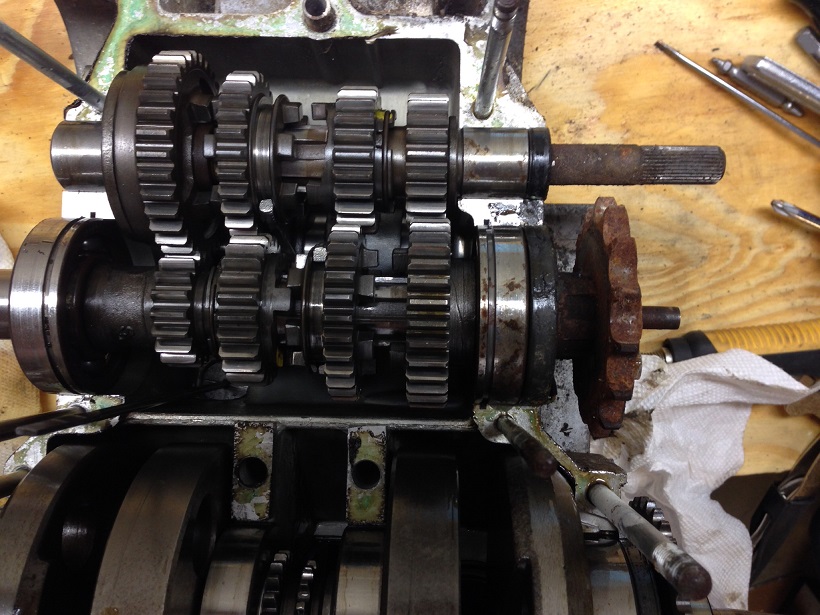

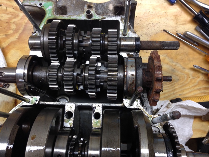

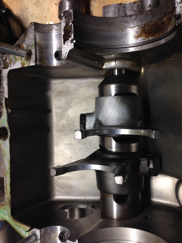

I got off my but and split the cases. In talking with Ed, this should make it easier to free my severely stuck pistons..
Anything look crazily amiss here?

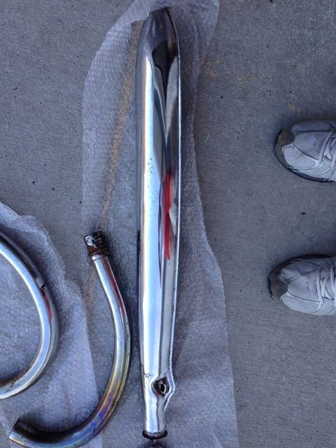

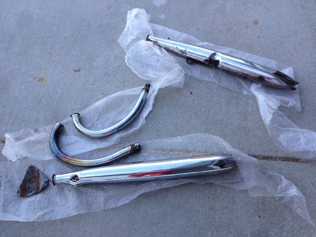

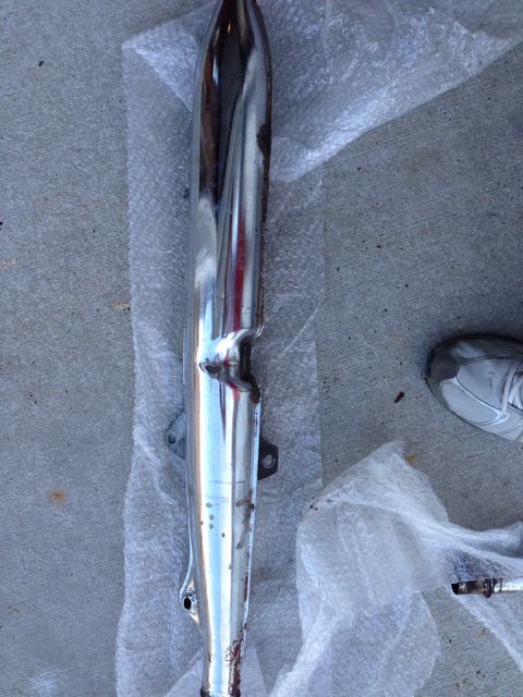

Well I have not done much recently with the bike. I have been working on a 1970 c70 as well. But I did just acquire these for the ridiculous price of $120 shipped :)
