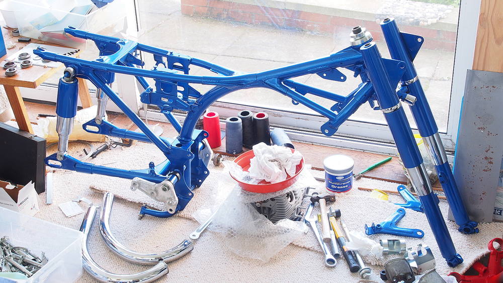

Lovely to see you using the "old girl". I have just started assembling my '64 SuperHawk and it's a nice feeling after 4 years of 'fettling'. Hoping to get the engine assembled this weekend.
