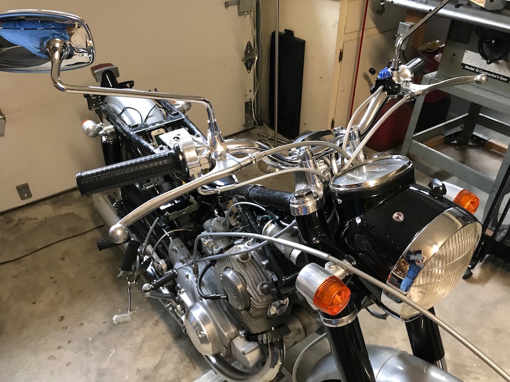

Post by Seadog » Sat Dec 02, 2017 3:56 pm
It has been months since I last posted, but puttering with the CB continues. I've most recently been installing new handlebars and cables, etc., plus freshening up the front end by replacing rusted/pitted//damaged parts and wiring. The last of those parts - new clutch and brake levers - arrived today. I'll soon be taking off the stator side cover to attach the new clutch cable and, while I'm in there, replace the kick start bushing and try to find a small pesky oil weep. When that's all accomplished, I plan to remove the front wheel to determine why the brake shoes return so slowly (and with an annoying creaking sound), even when the brake cable is off and the brake arm manipulated by hand. We shall see. Always something new to learn about.
