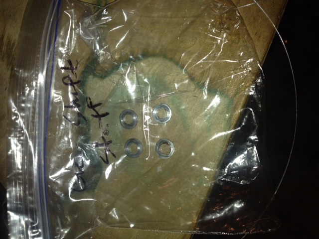

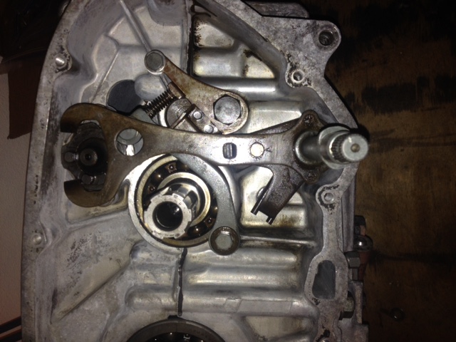

Post by Brickyard » Fri Nov 06, 2015 9:55 pm
Cases went together nice and smooth, nice lip of sealant around edges, case nuts and bolts are torqued and snug.
Calling it a night since after I installed shift drum, kick starter parts, and gearshift spindle, I had 4 washers left over. I can't remember if those were already on the bottom of my cleaning can when I dropped the clutch parts in the cleaning bucket, or not.
-_-
Brickyard
Posts: 135
Location: North Florida
Post by Brickyard » Fri Nov 06, 2015 10:00 pm
I didn't disassemble the gearshift arm/spindle assembly so the washers aren't from that...
