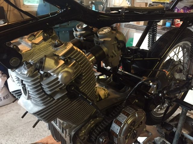

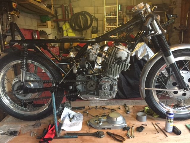

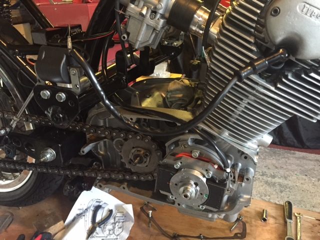

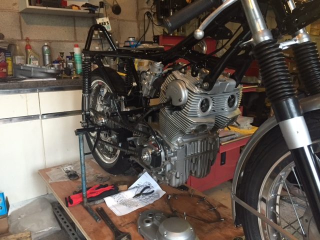

Progress to date
I haven't posted for sometime, but here is a few pics of my progress to date. Slowly coming together.
New electronic ignition fitted. Need to get some bits and bats re-chromed, but you can see her coming together.

Just been catching up on your progress,
As suggested previously a CB200 bung will fit straight in at the end of your selector drum, I have the part number somewhere if it helps., may even have a spare bung.
Nice work, what size are the gearbox / rear sprockets, the front looks bigger than standard which is 15t, looks 16 or even 17 Tooth, which suggest the bike was pulling a much higher gear than standard, They go best if you use the torque rather than revving them to death, most good race engines will run past 10k but don't seem to make any more power, just wear out faster so gear it up as much as it will cope with. Good Luck with the rest of your rebuild.
