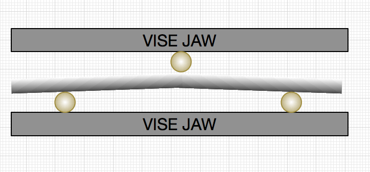

I disassembled the shock absorbers this morning and found both shafts to be slightly bent. I imagine some PO(s) bottomed out hard. Don't know what I'll do about that, since any replacements that I buy could very likely also be bent and I'm a bit weary of buying replacements that turn out to be worse that the part I'm trying to replace. The existing seals were holding, but the oil was black. I poured it into a container, but have yet to accurately measure it for replacement. I'll just clean the parts up for now, loosely assemble and bag. The lower covers need to be re-chromed before I can do much else.

If you are careful you can straighten out those damper rods with three short brass bars (or rollers) and put the whole assembly in the vise. You need three hands (and your knee) but it can be done. Just try a little squeeze then take the rod and roll it on a flat surface. You will soon learn where the bend is and what needs doing. I did a CL72 damper rod recently and got it pretty much perfect.

Thanks, G-Man. I did buy those seals a couple of weeks ago and just received them, so I'm good with that. It took me a bit of thinking about your straightening method, but unless I'm mistaken, you mean to lay the damper rod perpendicularly across the three brass rods, roll it to find the high spot, then take all four rods to a vice to pinch. Three hands and a knee might not be enough, but I can give it a try.

Sorry didn't make that very clear. In the vise, two rods go on one side of the damper rod and one on the other side at the high point of the bend. Close the vise up to straighten the rod using 'three point bending'. The three rods allow you to put the pressure in exactly the right place.

Still haven't tried to straighten the shock damper rods. I'll need some more brass rod and I think I'll need a larger diameter.

I thought a picture might be in order for the damper rod straightening. The two rods at the bottom can be adjusted inwards or outwards to put th ebending effort in just the right place...
