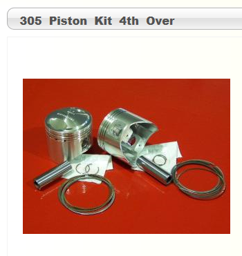

While we are on the topic...below are the pistons I ordered (61.00mm), would you recommend that I go 2 TH clearance with these as well or should different calculations be made?
Also, what does TH stand for? lol
Post by LOUD MOUSE » Thu Jul 16, 2015 10:27 am
In this case I suggest you ask Tim that question as he had WISCO build them.
TH is for THOUSAND. ......................lm
rideordie wrote:Much appreciated LM, personal experience is always good advice!

Post by rideordie » Thu Jul 16, 2015 2:30 pm
Apparently the clearances are printed on the box specifically for each differently sized piston. Simple enough I suppose. I'm sure I can trust his marks being he specializes in these machines...
