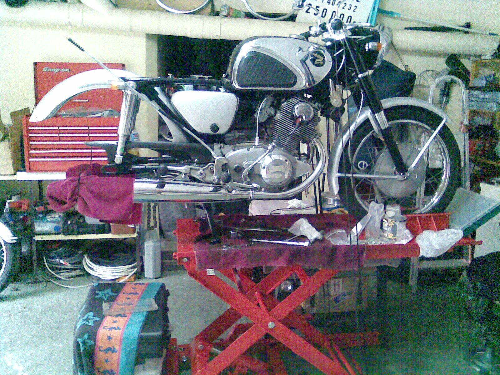

I'll soon be dropping the motor for surgery, now that my workshop improvements are progressing (bike lift!) and my engine jack has arrived. I can't be doing with back strain and knee pain any more!

And I wish I had a lift like yours--way easier on the back!
