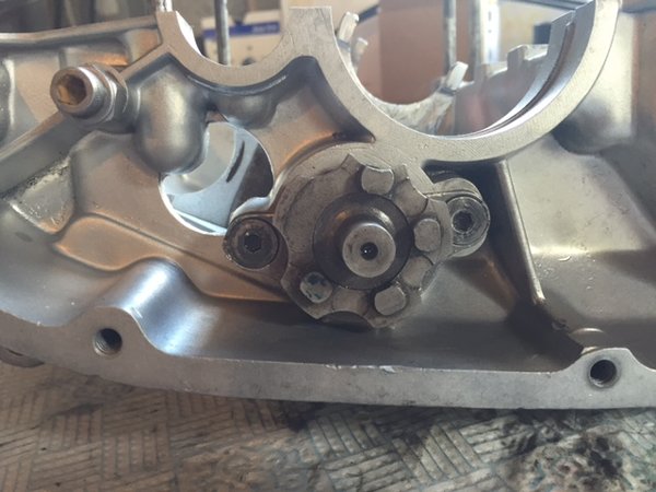

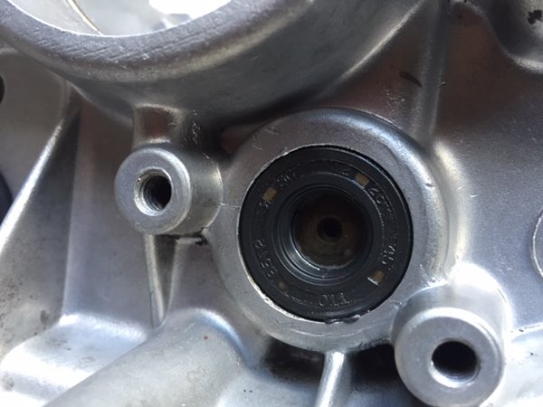

Some pics of the gear selector and the oil seal at the end of the selector. Doesnt seem to pass through the seal. Any clues on this one?
Dave
End of the gear selector.
Oil seal end. Doesn't seem to reach it.
Post by G-Man » Tue Aug 04, 2015 11:09 am
Dave
The bit on the end of the standard shift drum operates the neutral switch which isn't needed on your bike so you could just get a bung made to block that off. A simple aluminium plug with an O-ring should work.
lloydy1 wrote:Some pics of the gear selector and the oil seal at the end of the selector. Doesnt seem to pass through the seal. Any clues on this one?
